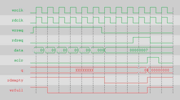

Fig. 1 : Wave showing read and write operation.
The above waveform shows the behavior of the design under normal read and write conditions with aclr .

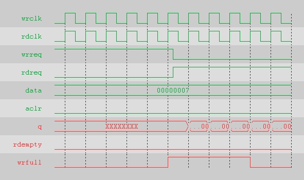

Fig. 2 : Wave showing FIFO full operation.
The above waveform shows the behavior of the FIFO under wrfull condition. In the example above, data is written into the FIFO till it is full, then data is read back.
