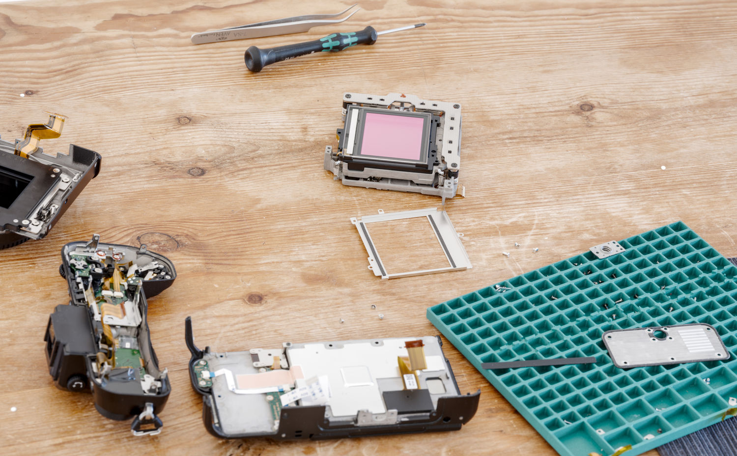

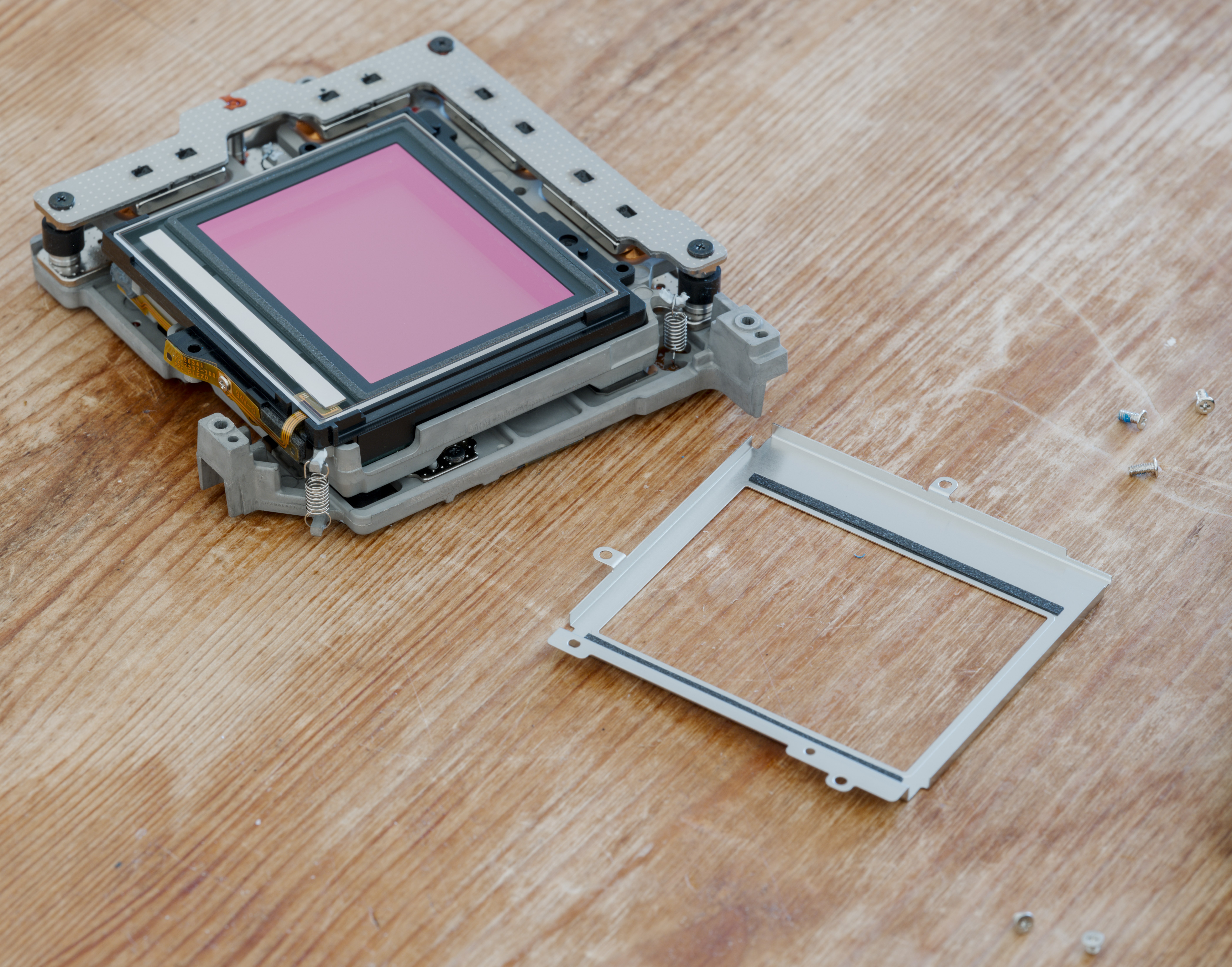

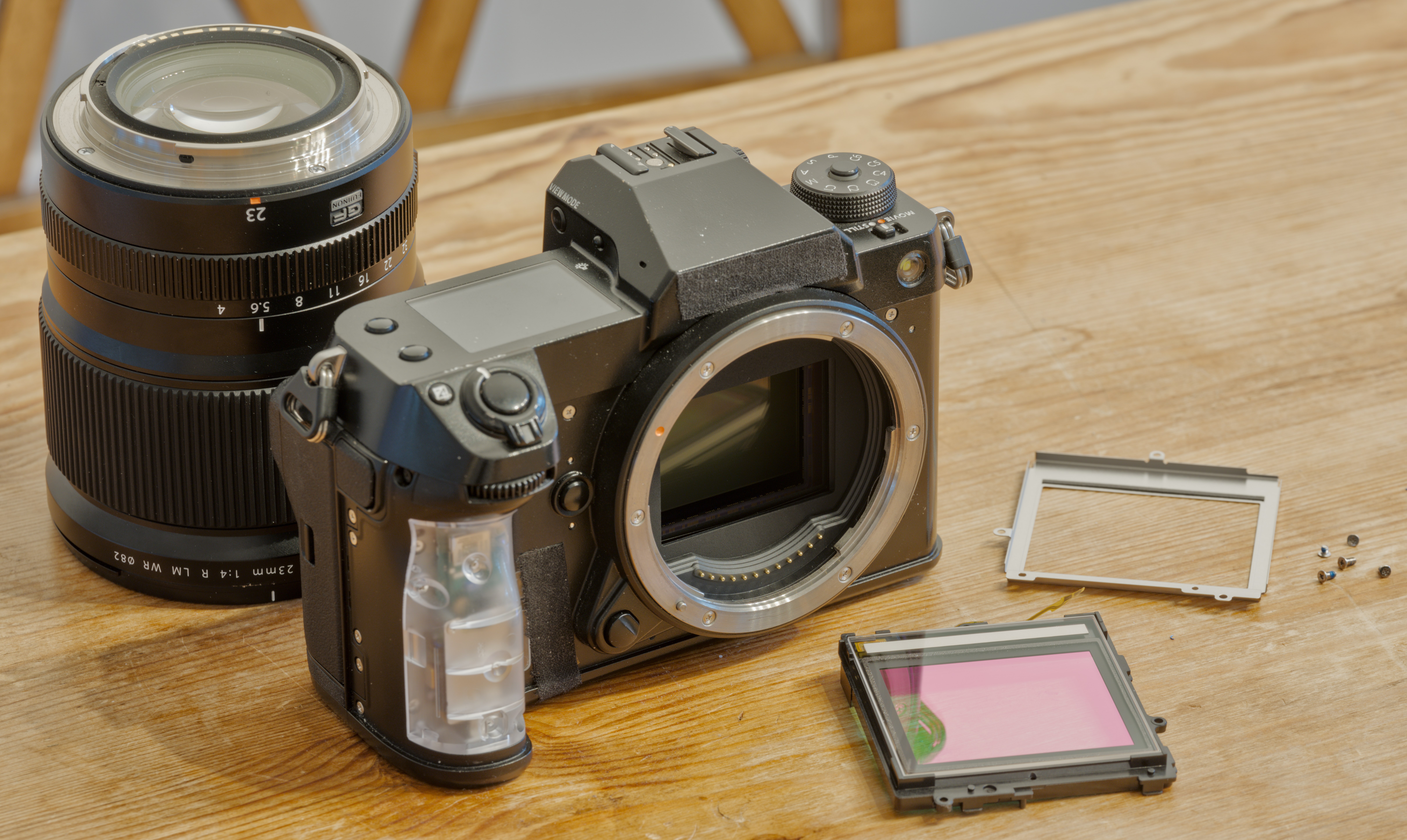

Couple of the hi-res photographs of the camera conversion key steps. Fujifilm GFX 50S II camera disassembly process is pretty simple and doable without any special equipment, just a screwdriver and good quality tweezers to pull out various flexible cable connections between modules.

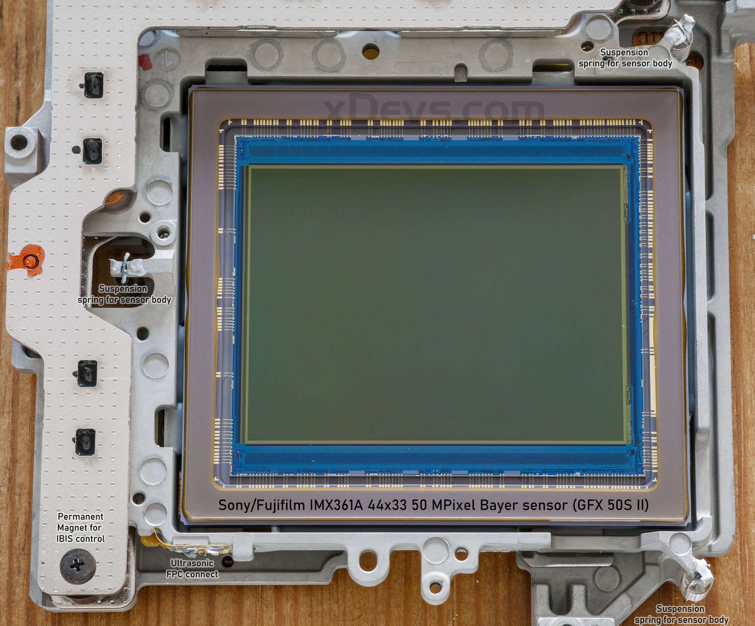

Sensor unit is held in the body by three long bolts. There are fragile shims under each one of them to level the sensor assembly relative to the body. Do not remove them and keep them in place to maintain alignment of the sensor plane!

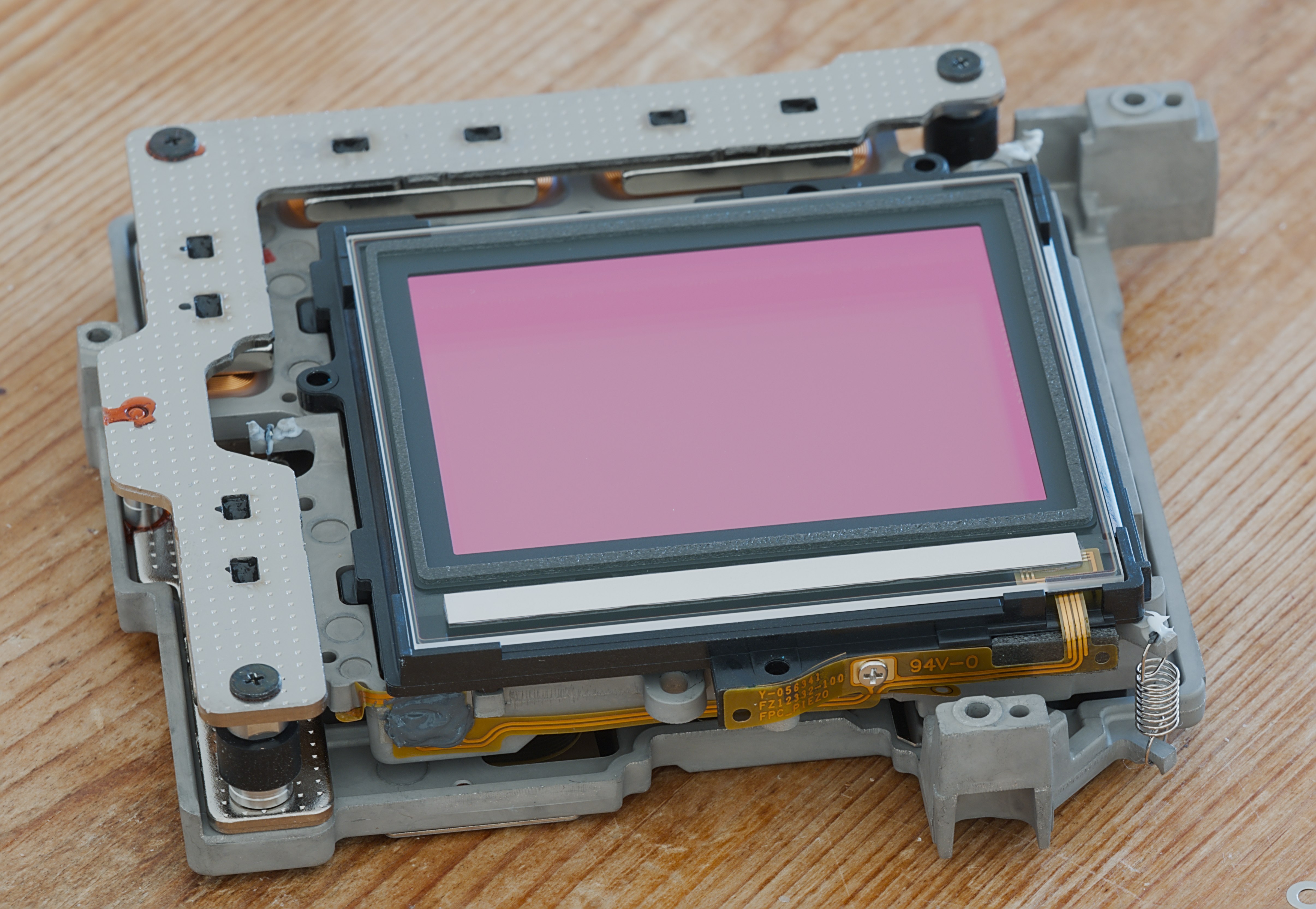

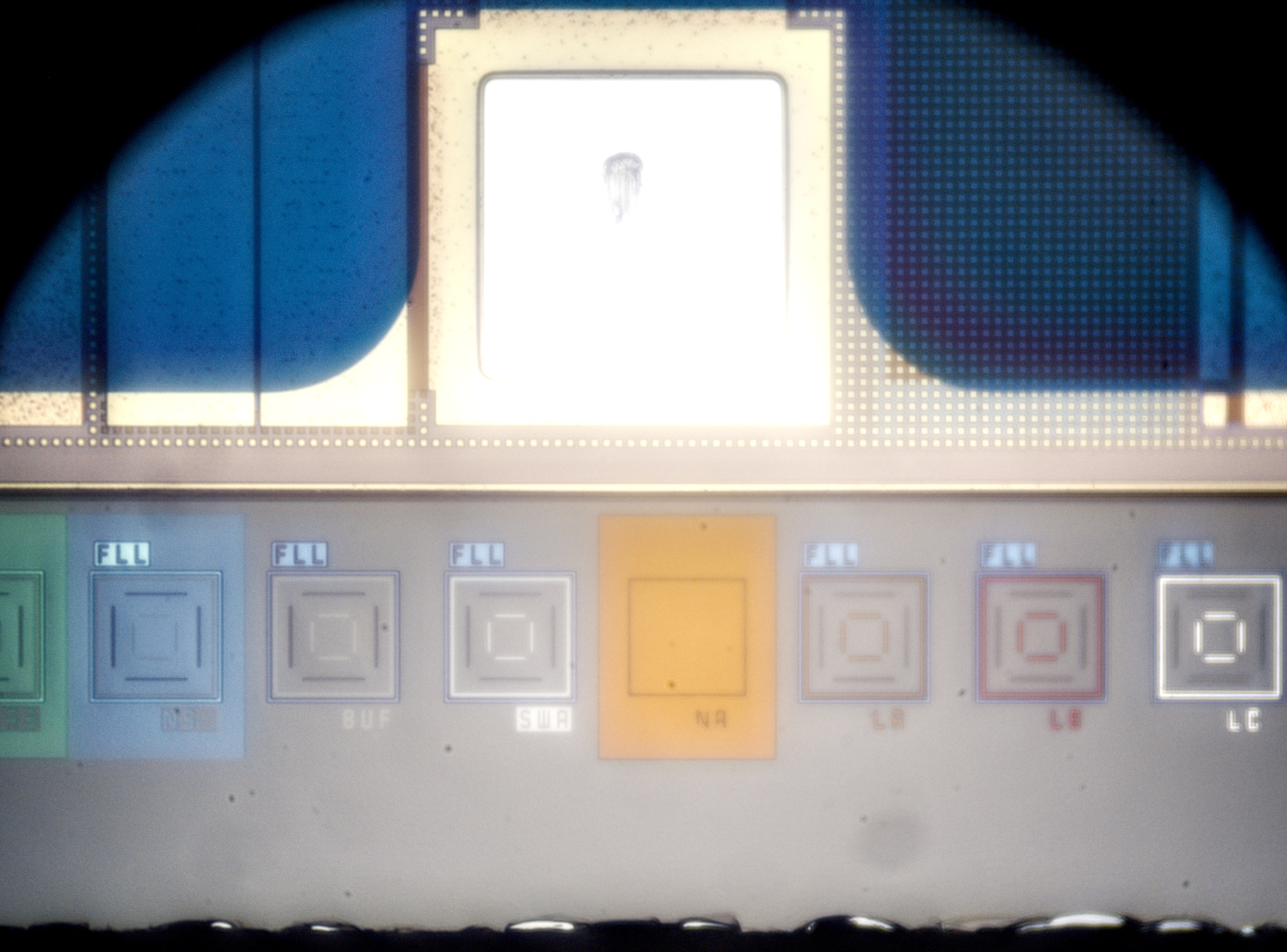

Then you’d need a soldering iron to desolder ultrasonic actuator power cable from the side of the sensor body and carefully detach the filter with ultrasonic cleaner.

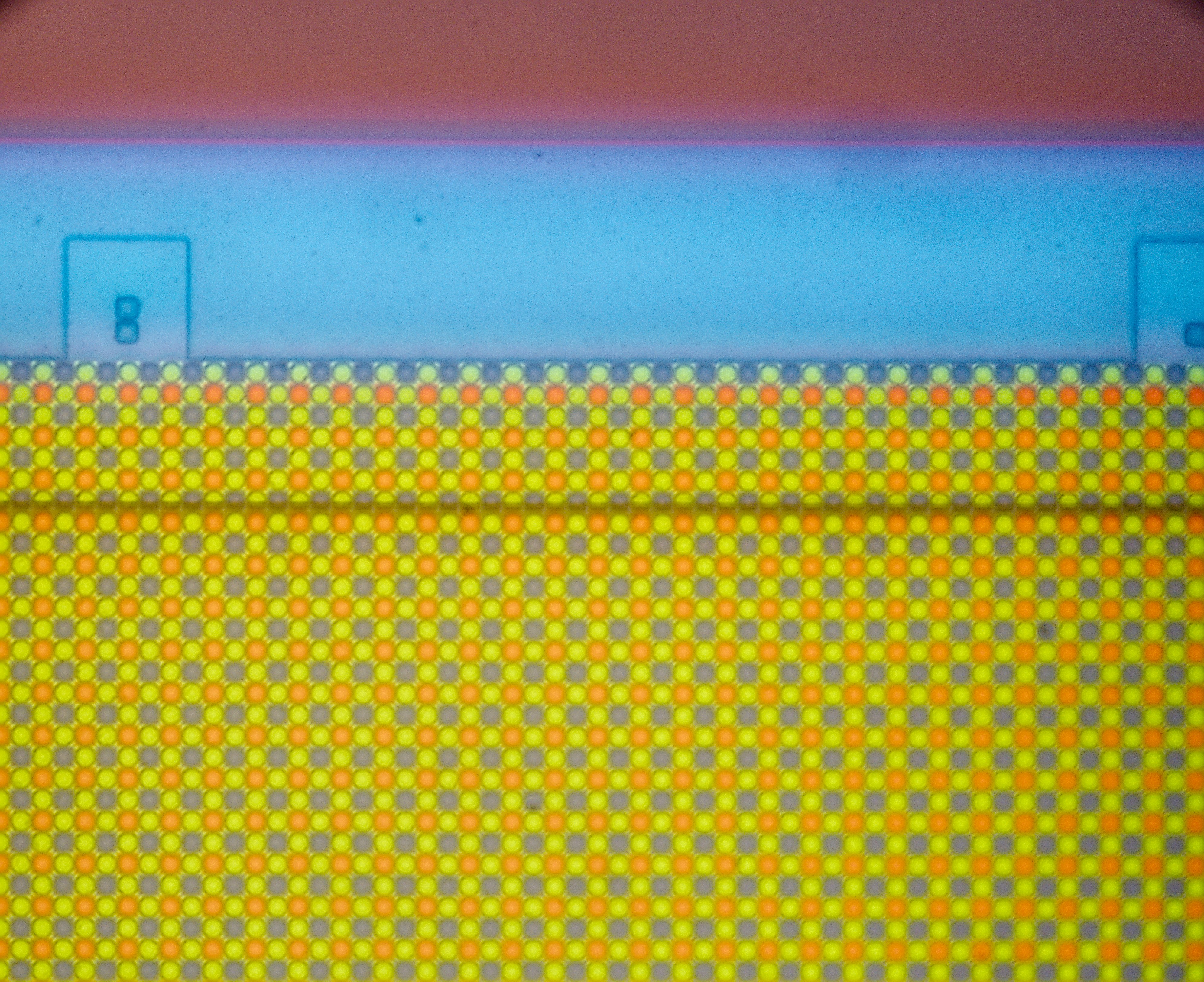

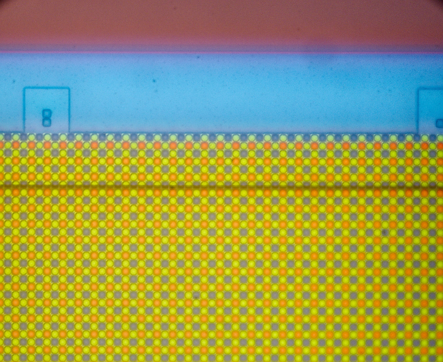

Now sensor is fully exposed to all light. It is also exposed to whatever dust and dirt particles around, so make sure you don’t touch the surface of the sensor and blow off gently any dust particles that lens on sensor protective glass cover. Because of much smaller distance to the pixels even tiny specks of dust will be clearly visible on the photographs, even at fully open apertures like f/4.0 or f/2.8.

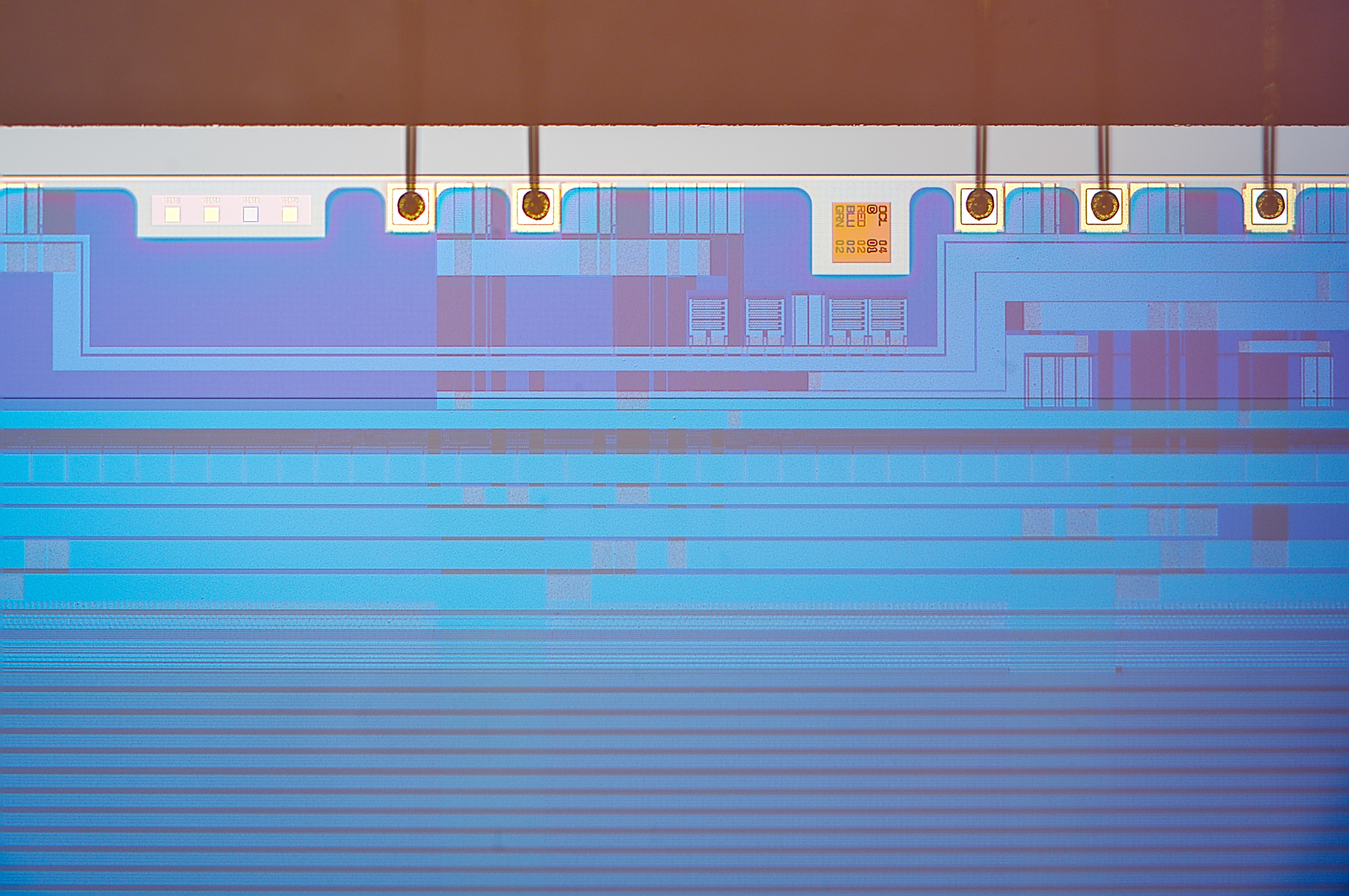

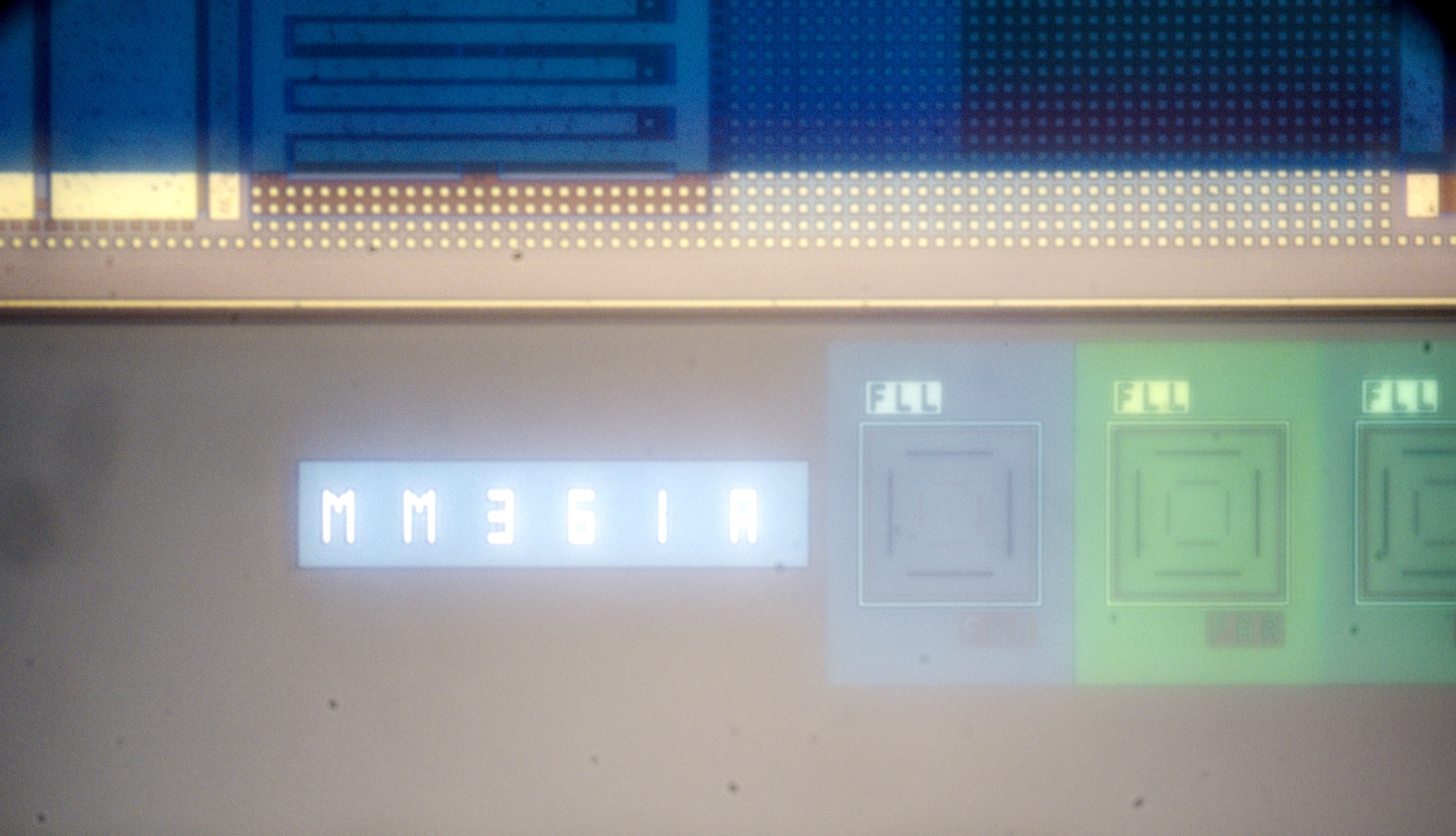

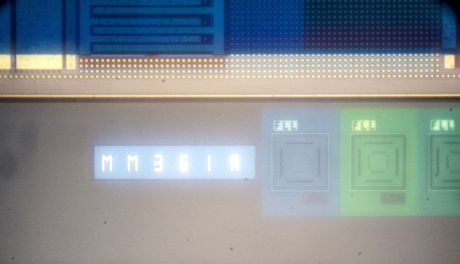

FLL perhaps stands for “Filter Lens Layer” for coating above different sub-pixels to provide red, green and blue pattern for colour imaging. MM361A likely stands for Sony IMX361A sensor model that is used in this Fujifilm GFX 50S II camera.
And de-filtered camera is now ready for tests:

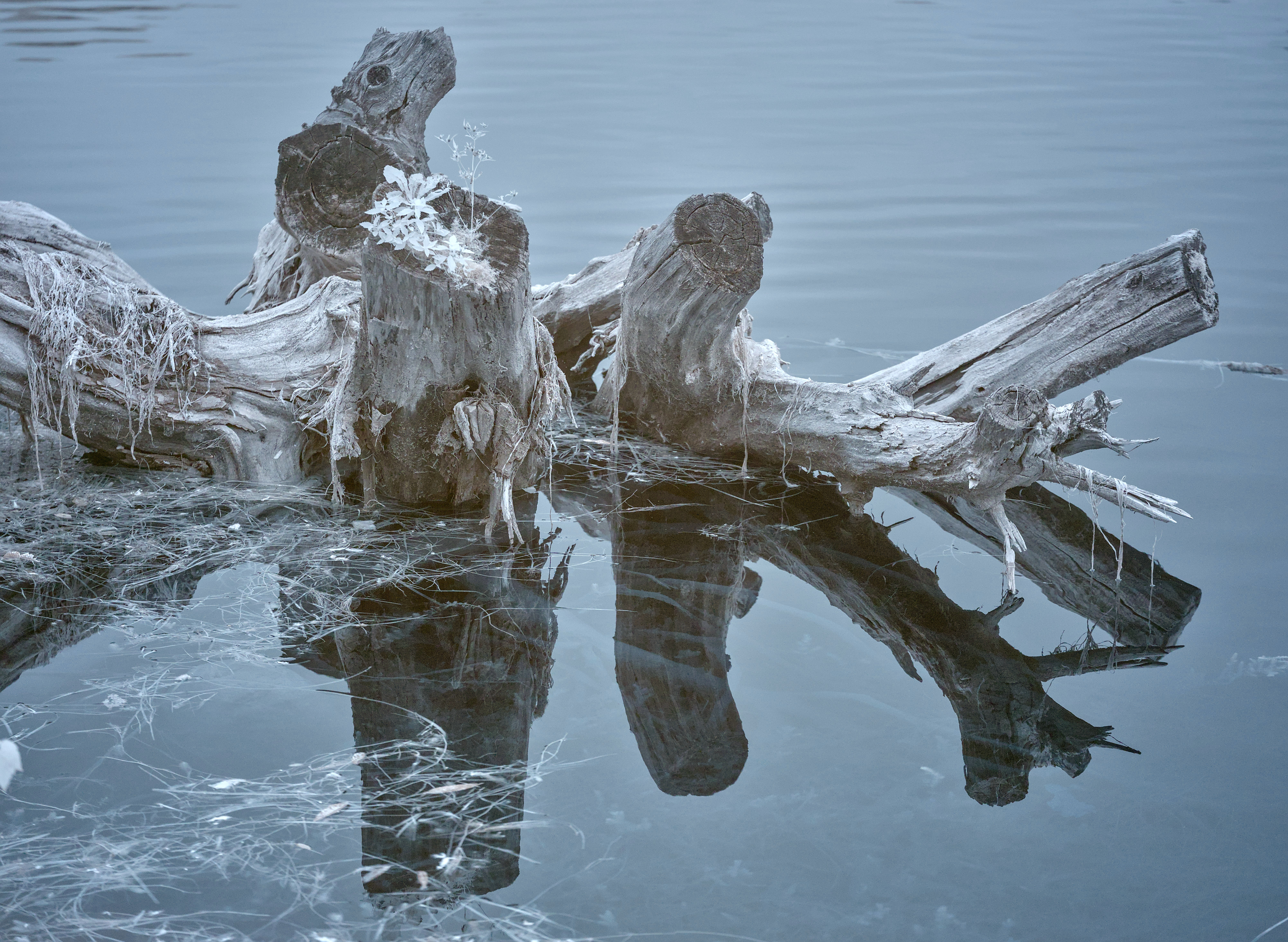

Here are test photographs captured with modified and regular camera during test session October 4, 2026 in Quebec, Canada. All images are corrected for whitebalance and curves with darktable. Most of images captured with Fujifilm GF 120/4 lens and IR pass filter on front.

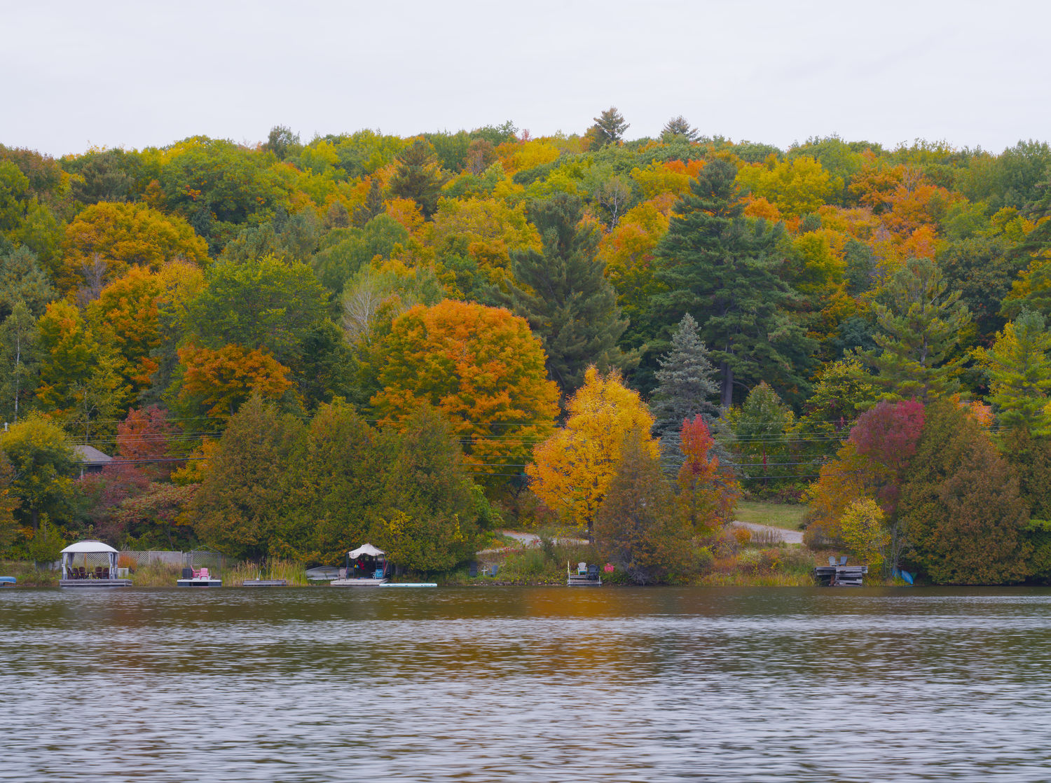

Regular vision camera (Fujifilm GFX 100 II Project Poseidon) with same lens as reference.

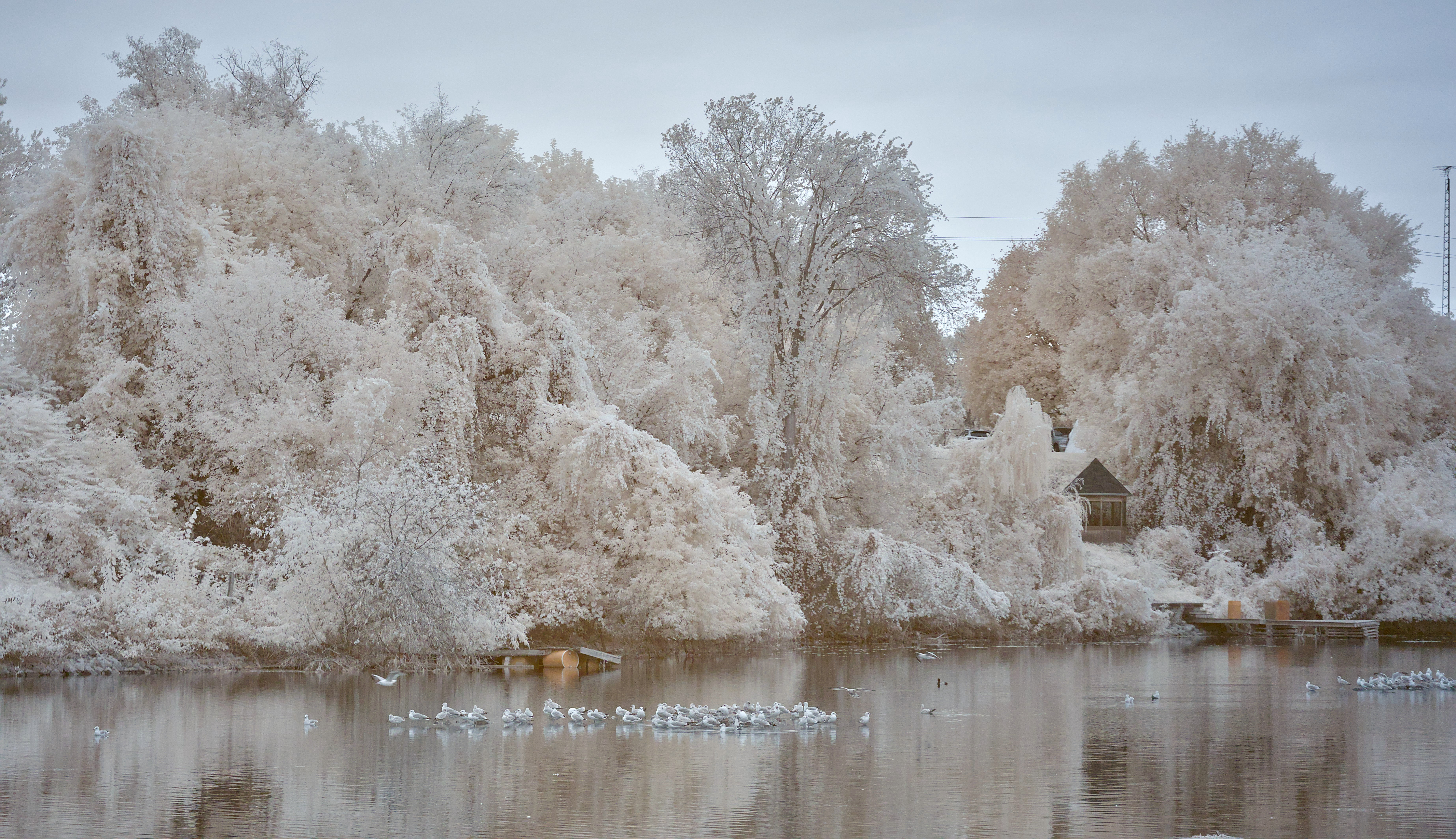

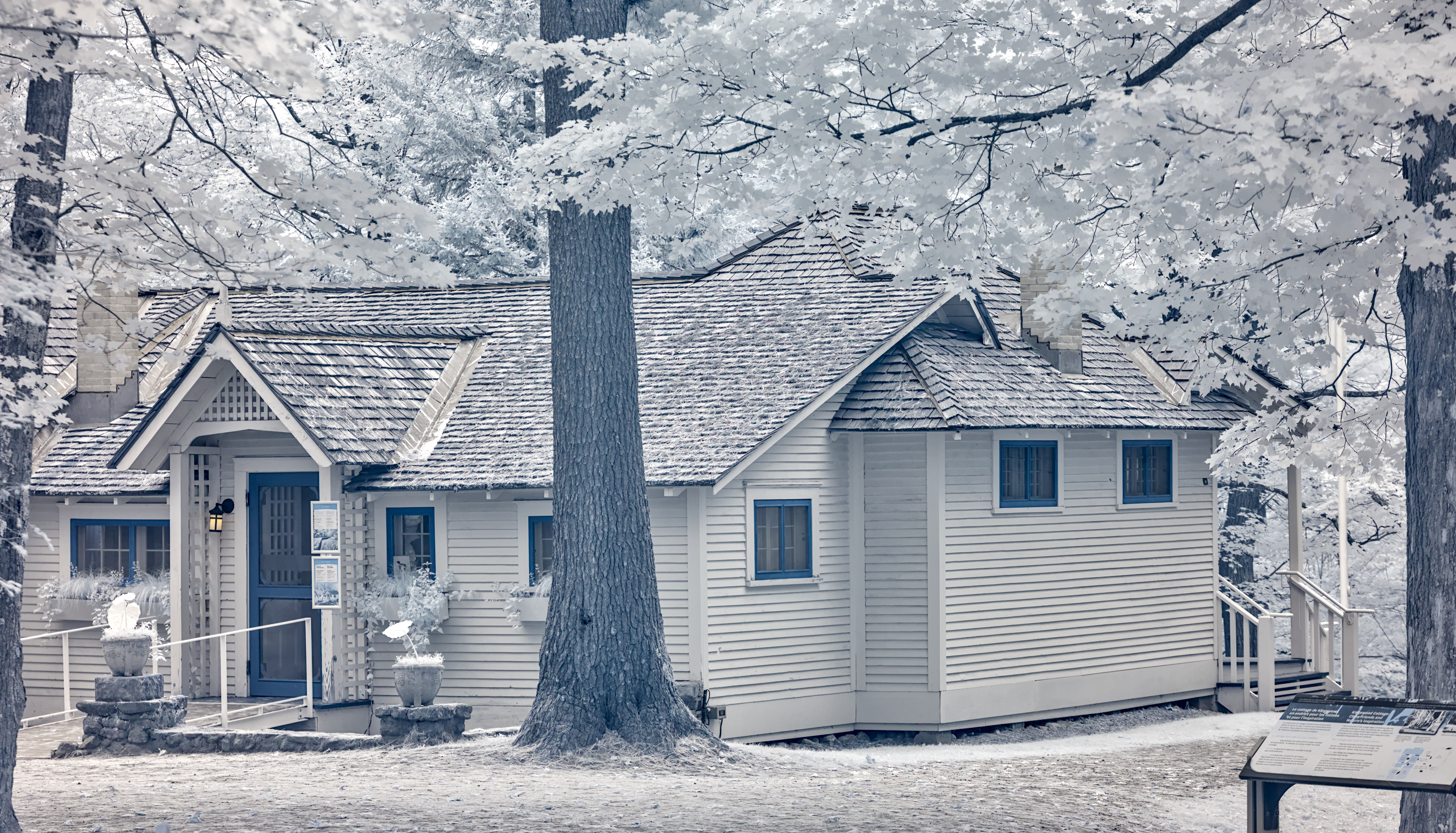

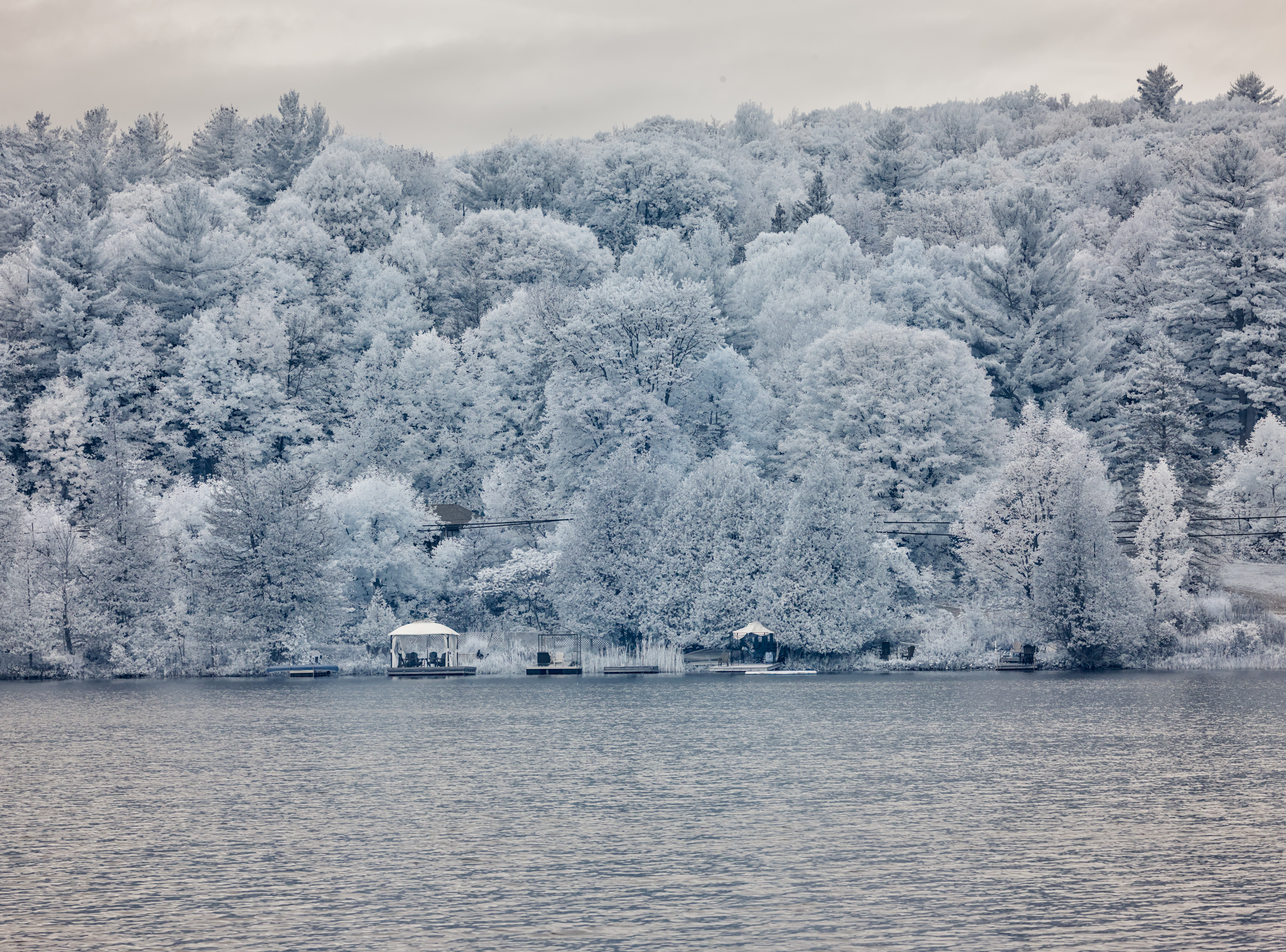

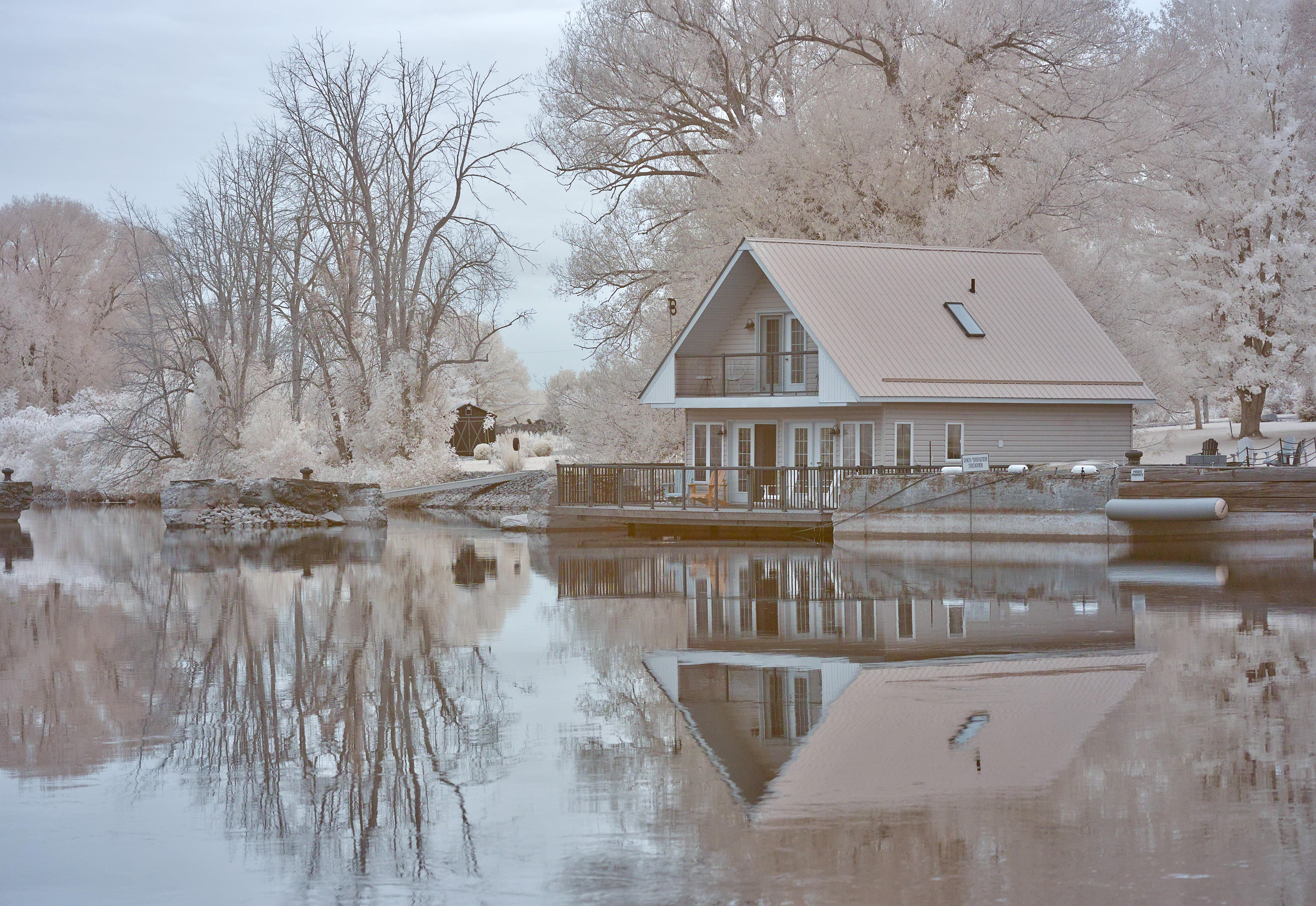

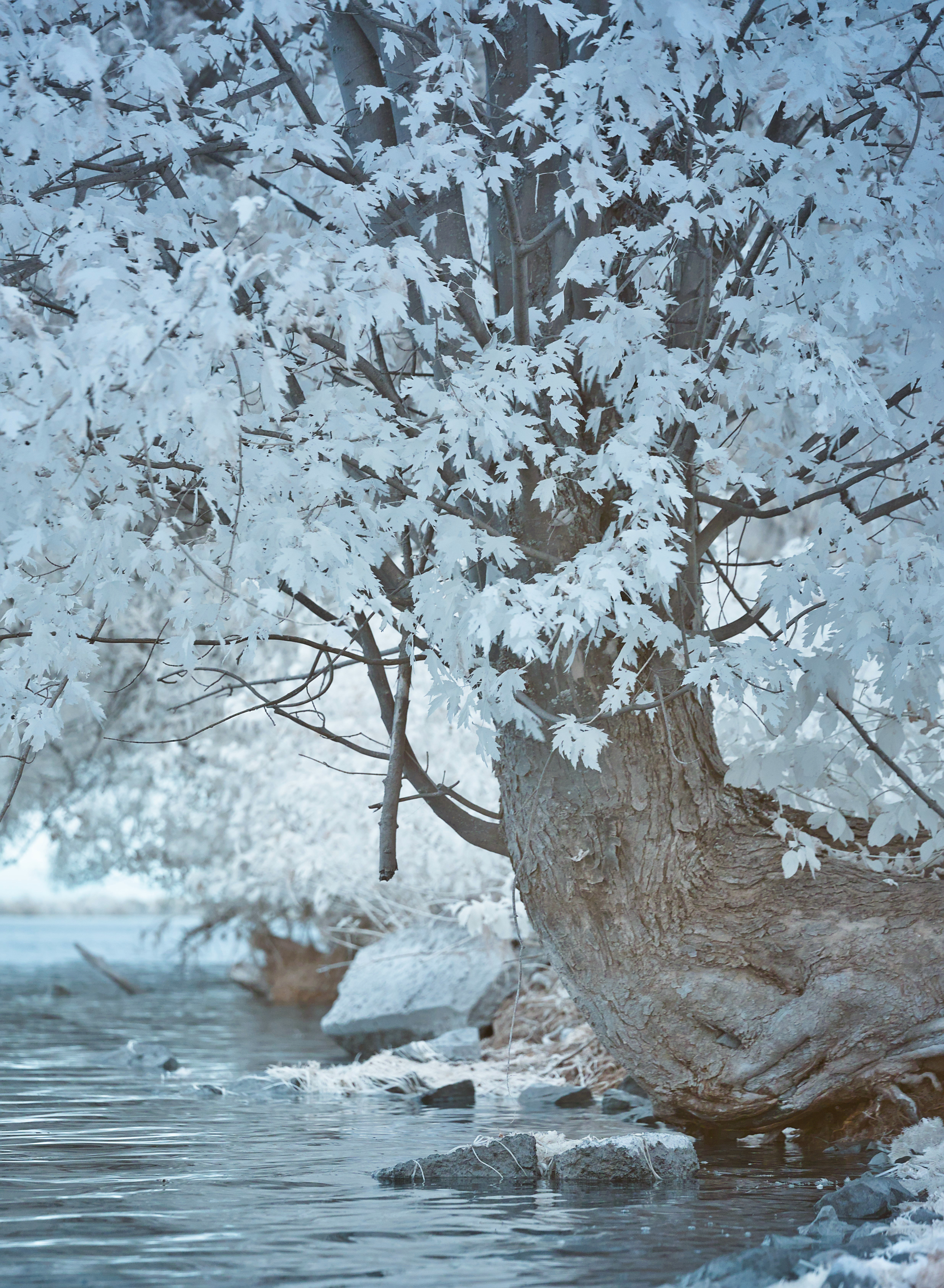

Infrared from modified GFX 50S II with IR filter on GF120/4 lens:

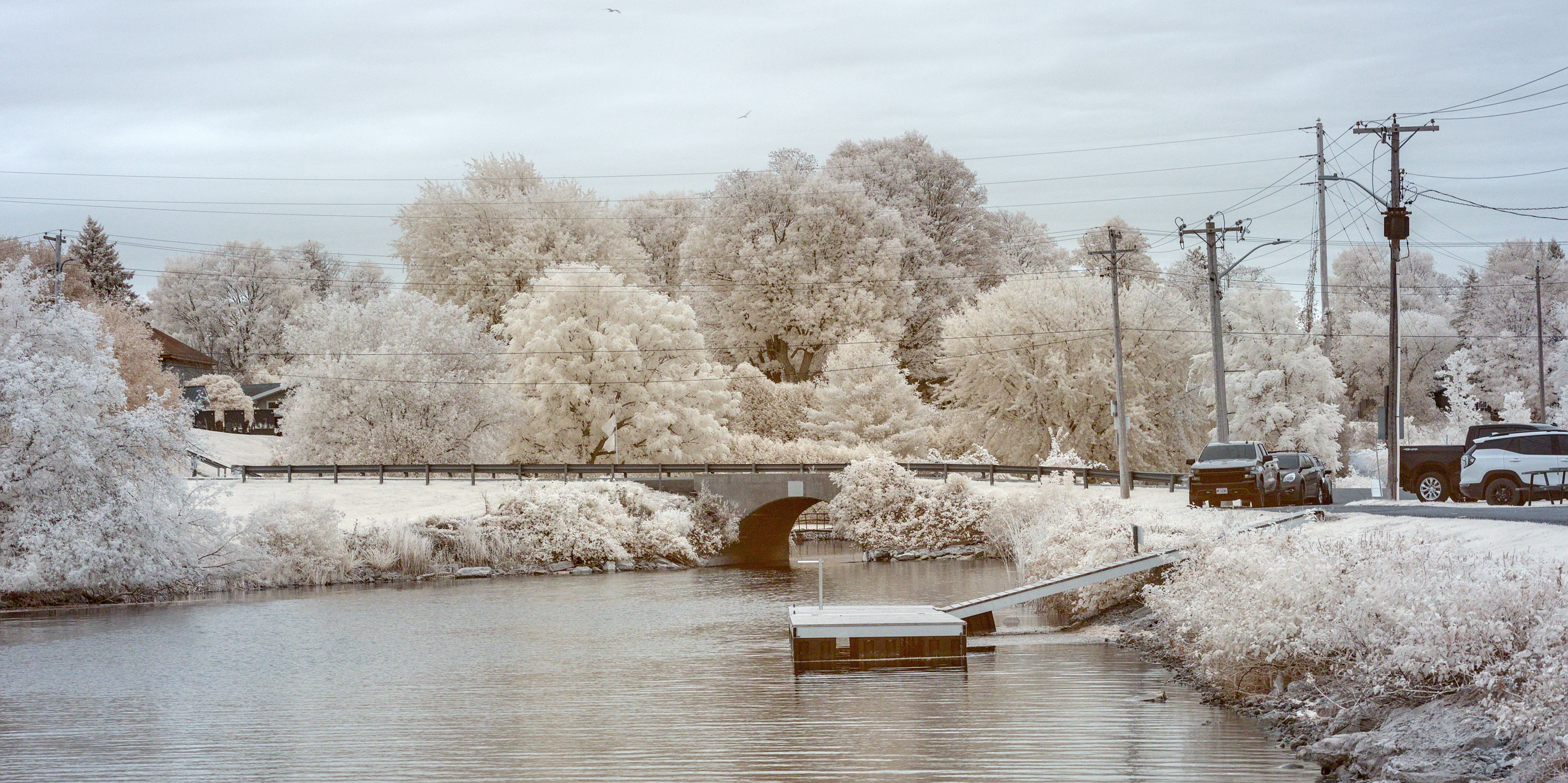

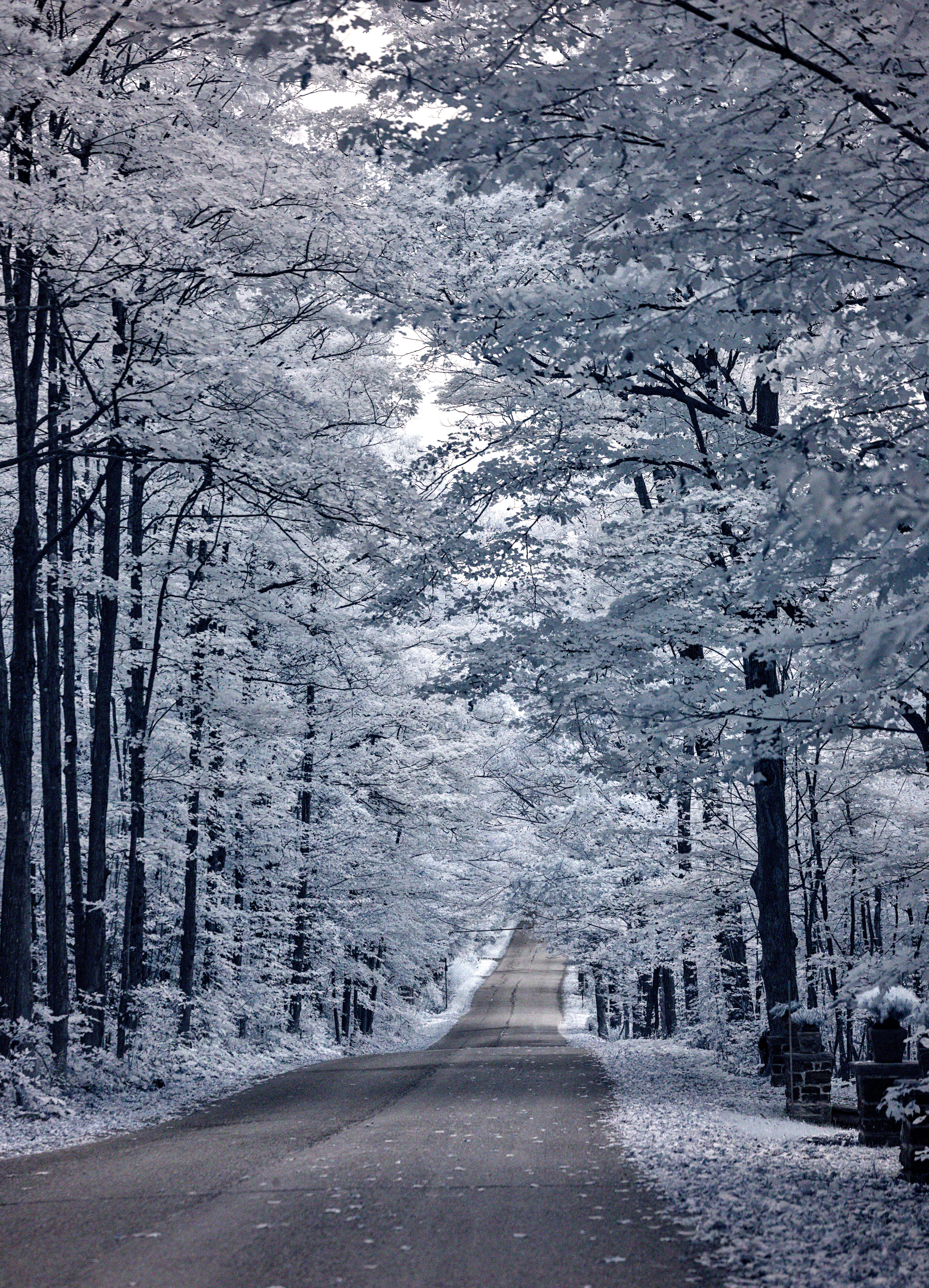

Next photo is one of impressive shots resembling winter, but without actual snow thanks to reflection of green light that turns leaves into white sheets instead. :)

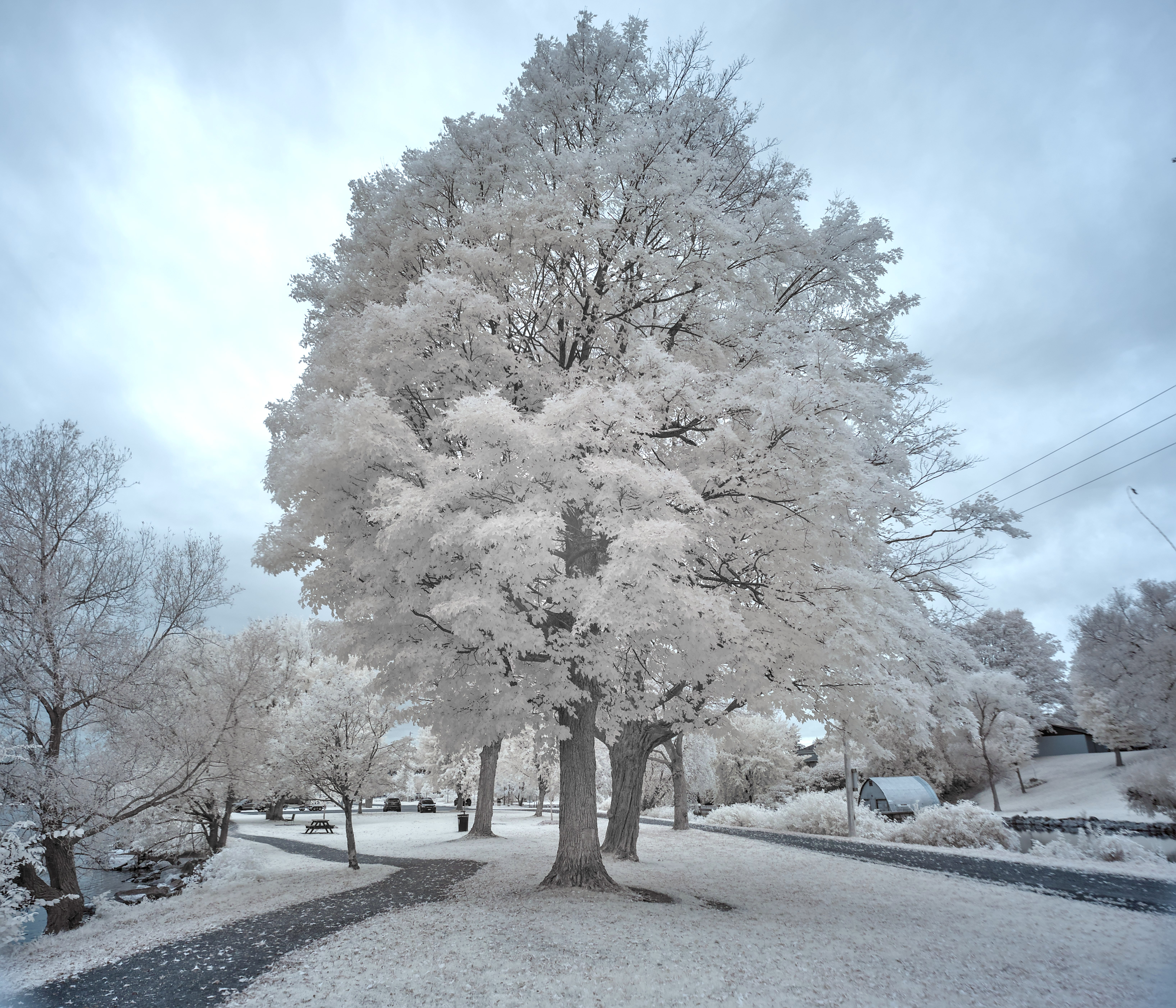

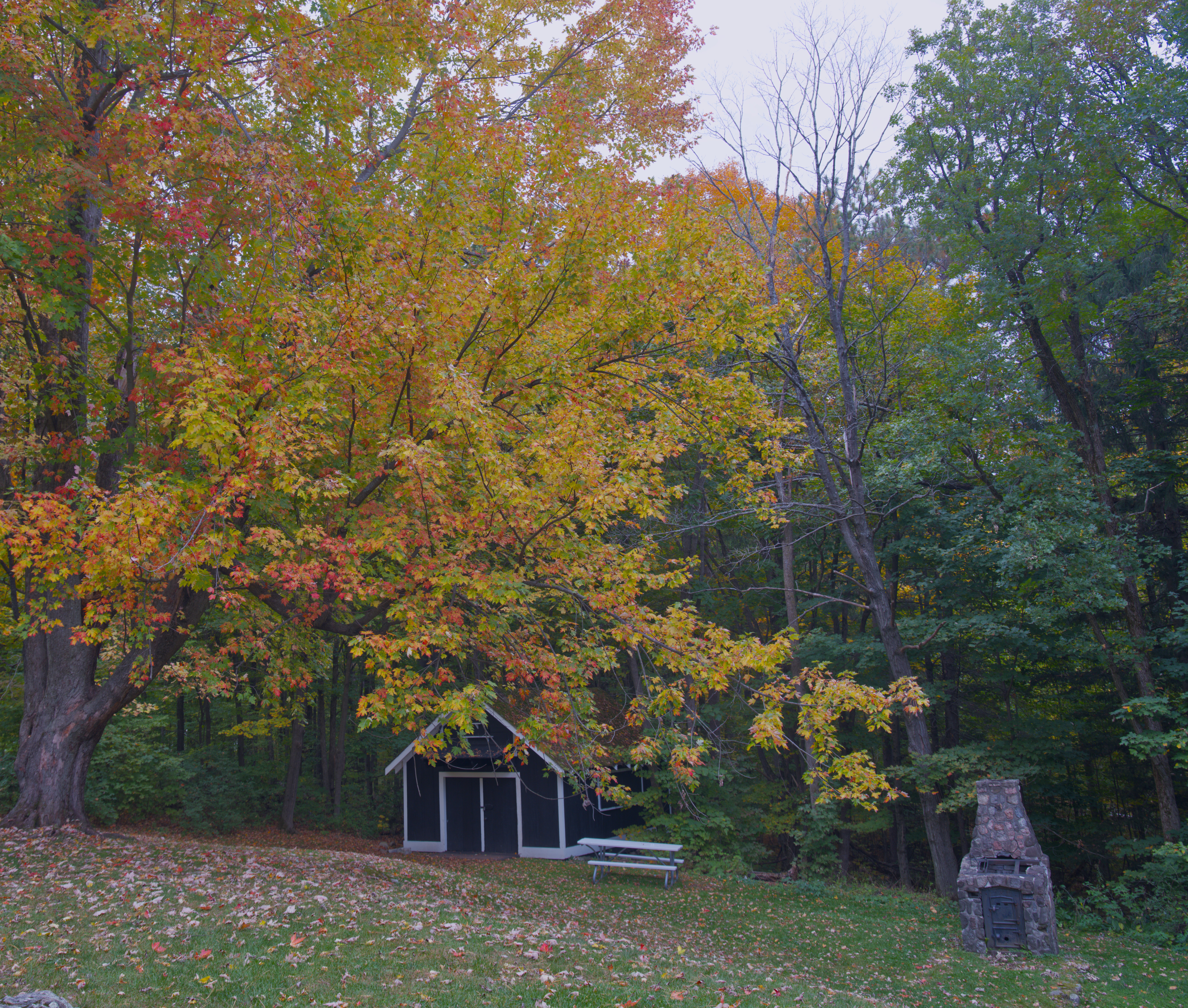

Infrared from modified GFX 50S II with IR filter on GF120/4 lens. Interesting that yellow leaves don’t look much different than regular green ones in infrared spectrum.

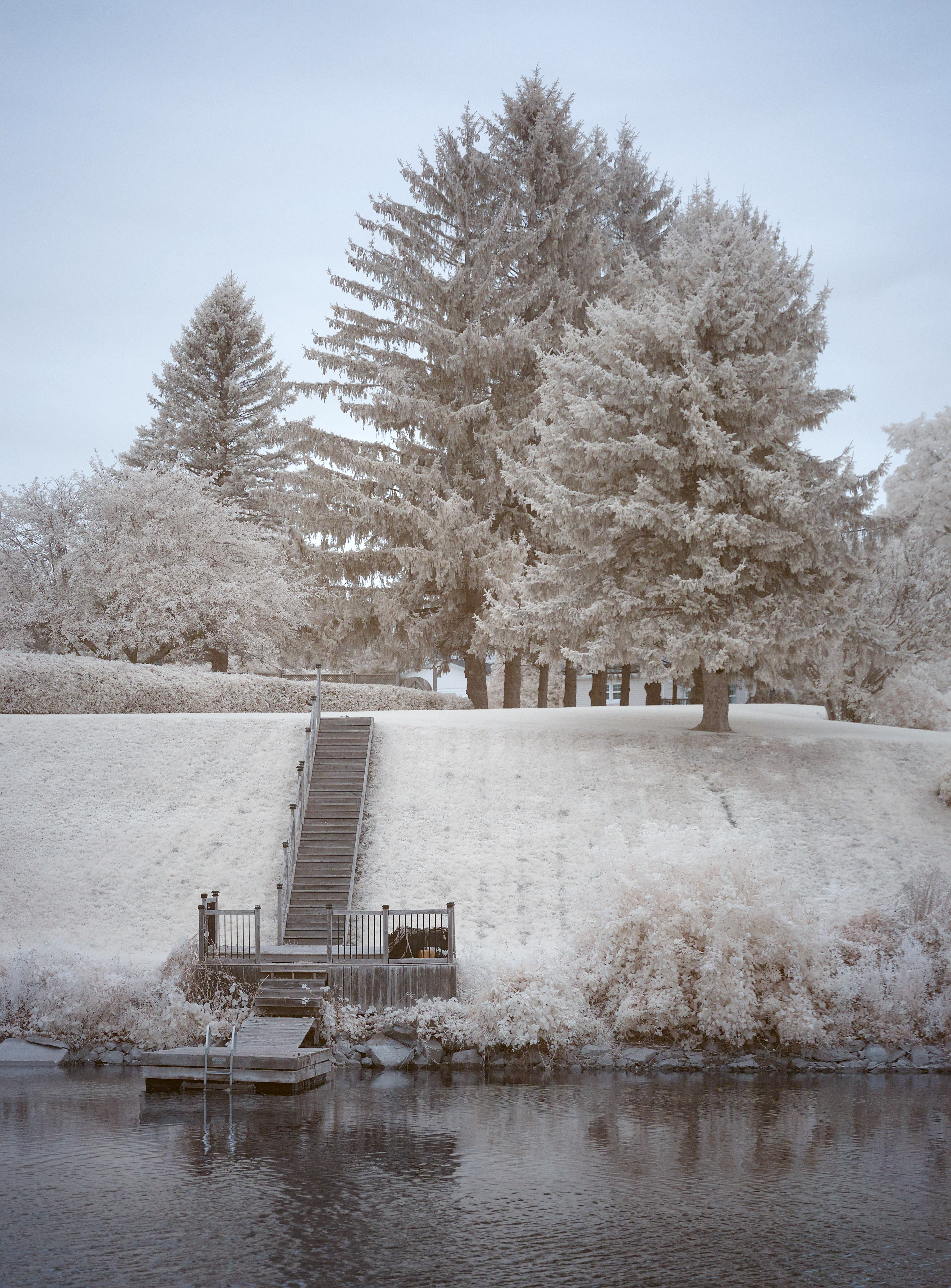

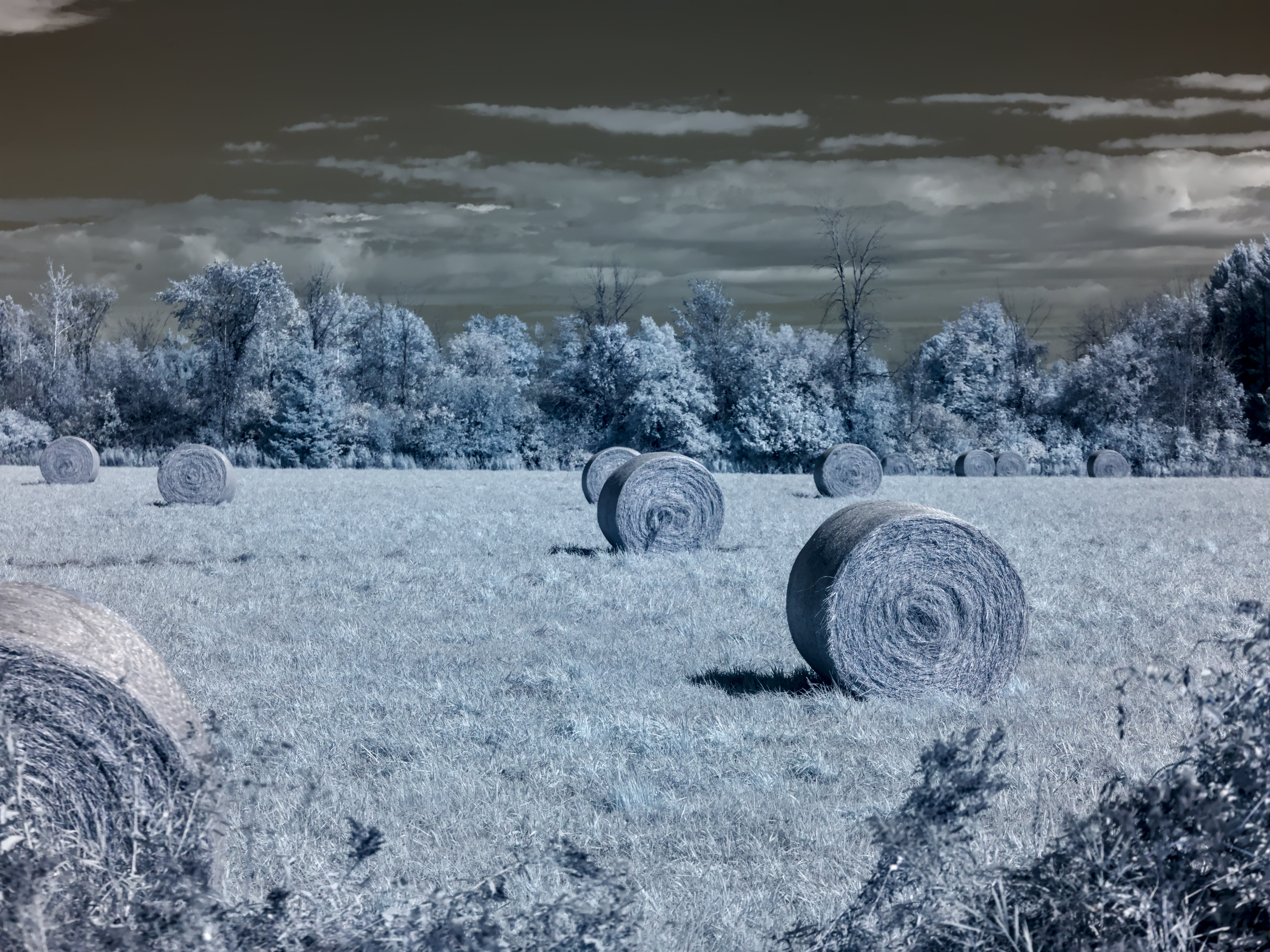

First is GFX 50S II in infrared with IR pass filter, 1/8” f/11 ISO 100:

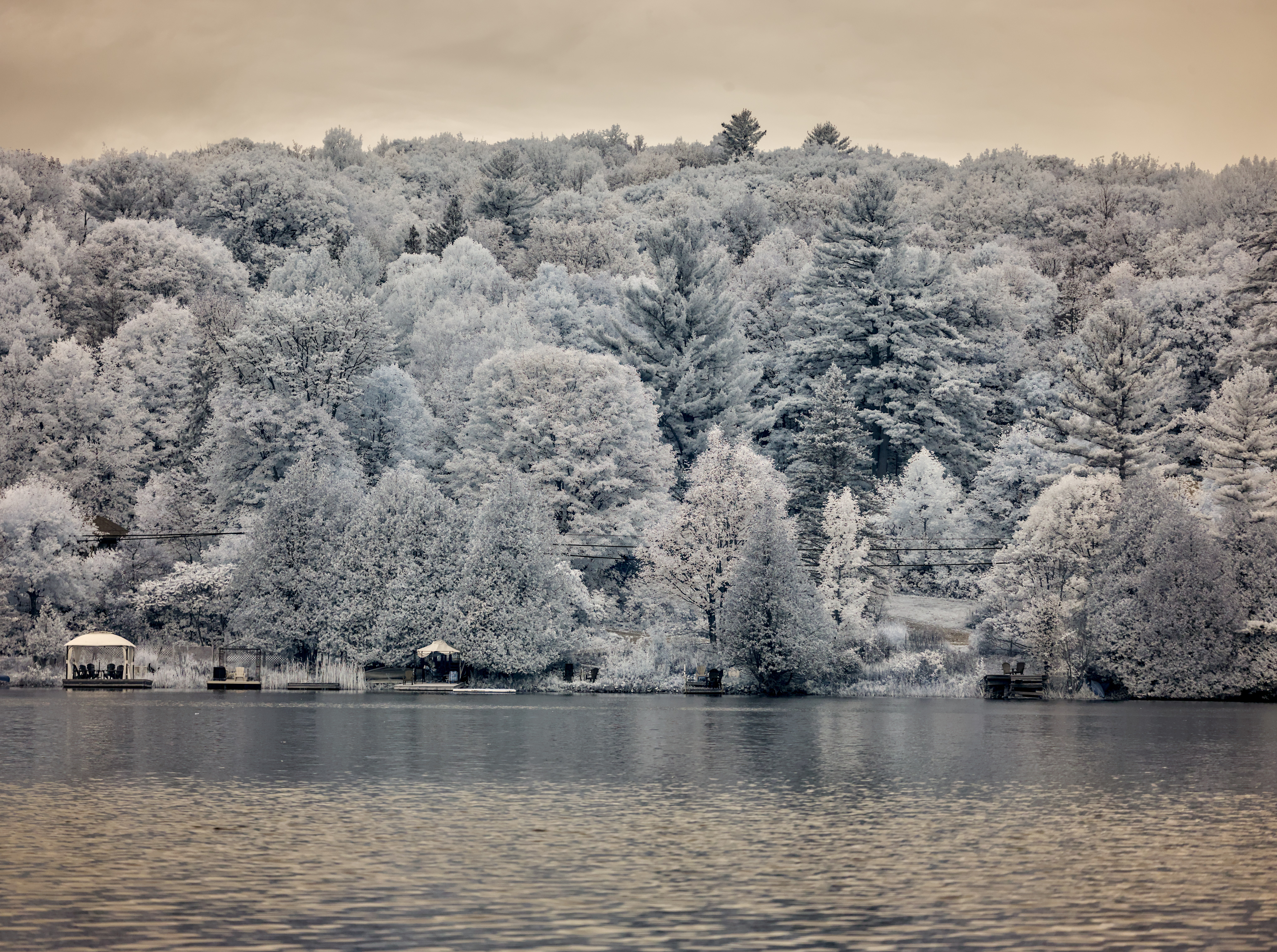

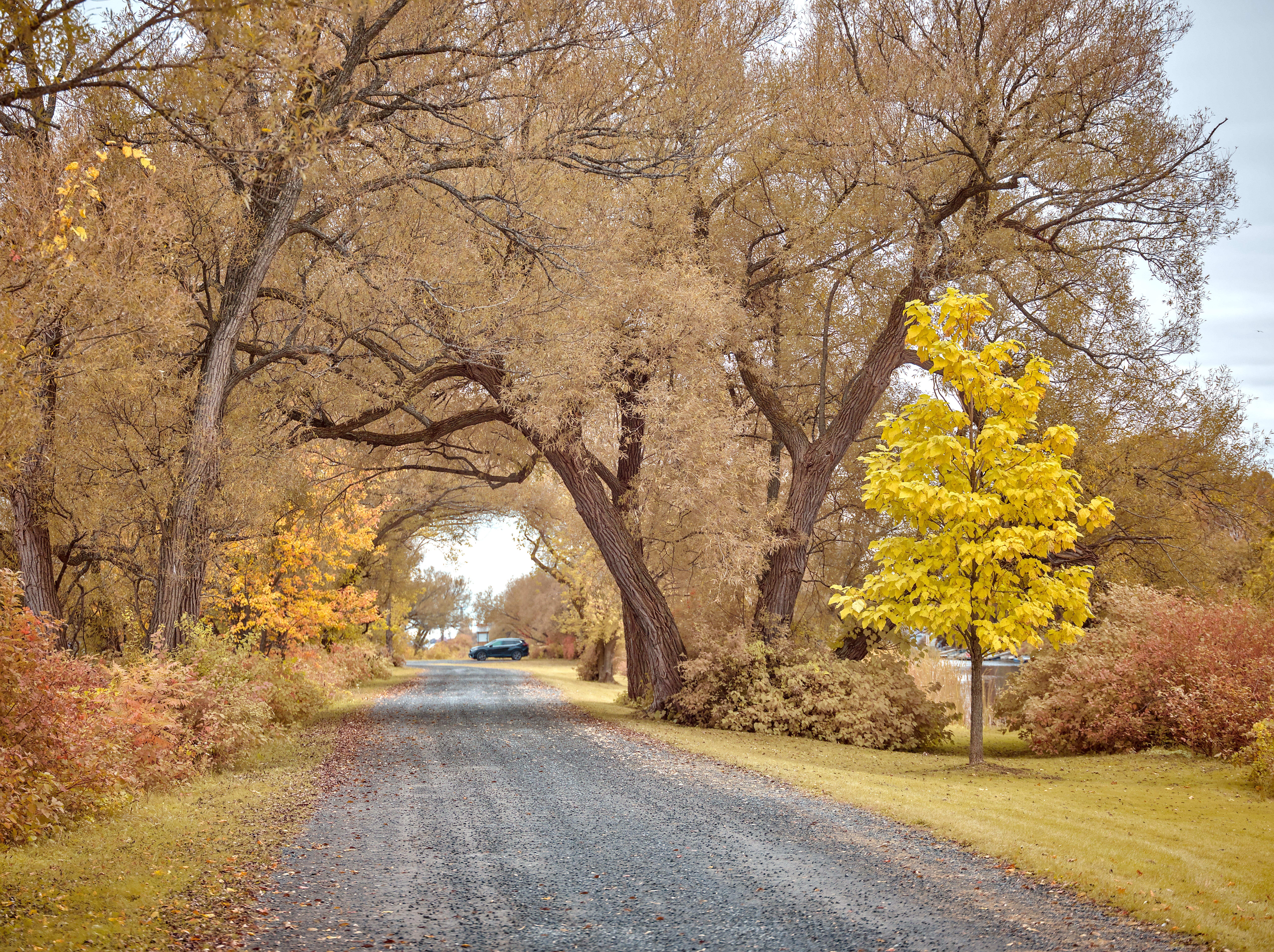

Then same modified camera but without any filter on the lens, capturing both UV+visible+IR components. Because IR spectrum contributes much more than other colors we get this sepia look as result, 1/25” f/11 ISO 100:

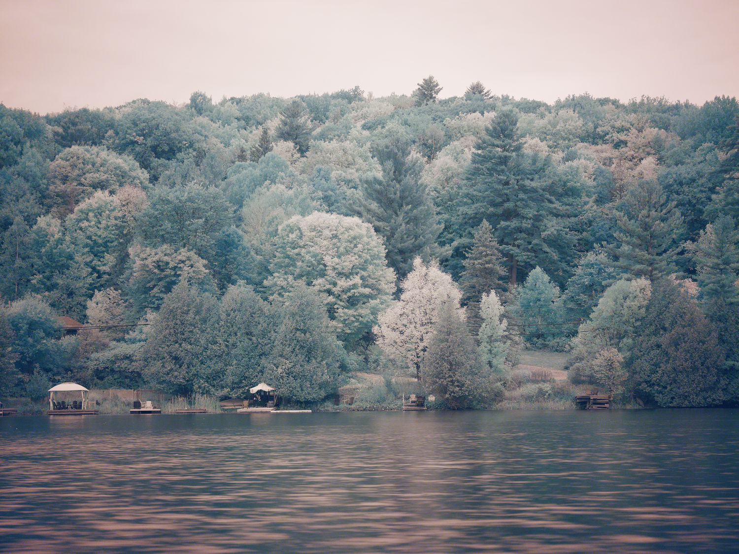

And finally regular camera (Fujifilm GFX 100 II Project Poseidon) with same lens but with IR passfilter attached, and at much longer exposure 0.8” f/4 ISO 1600. Lot of color is uneven and broken out, compared to modified GFX 50S II above.

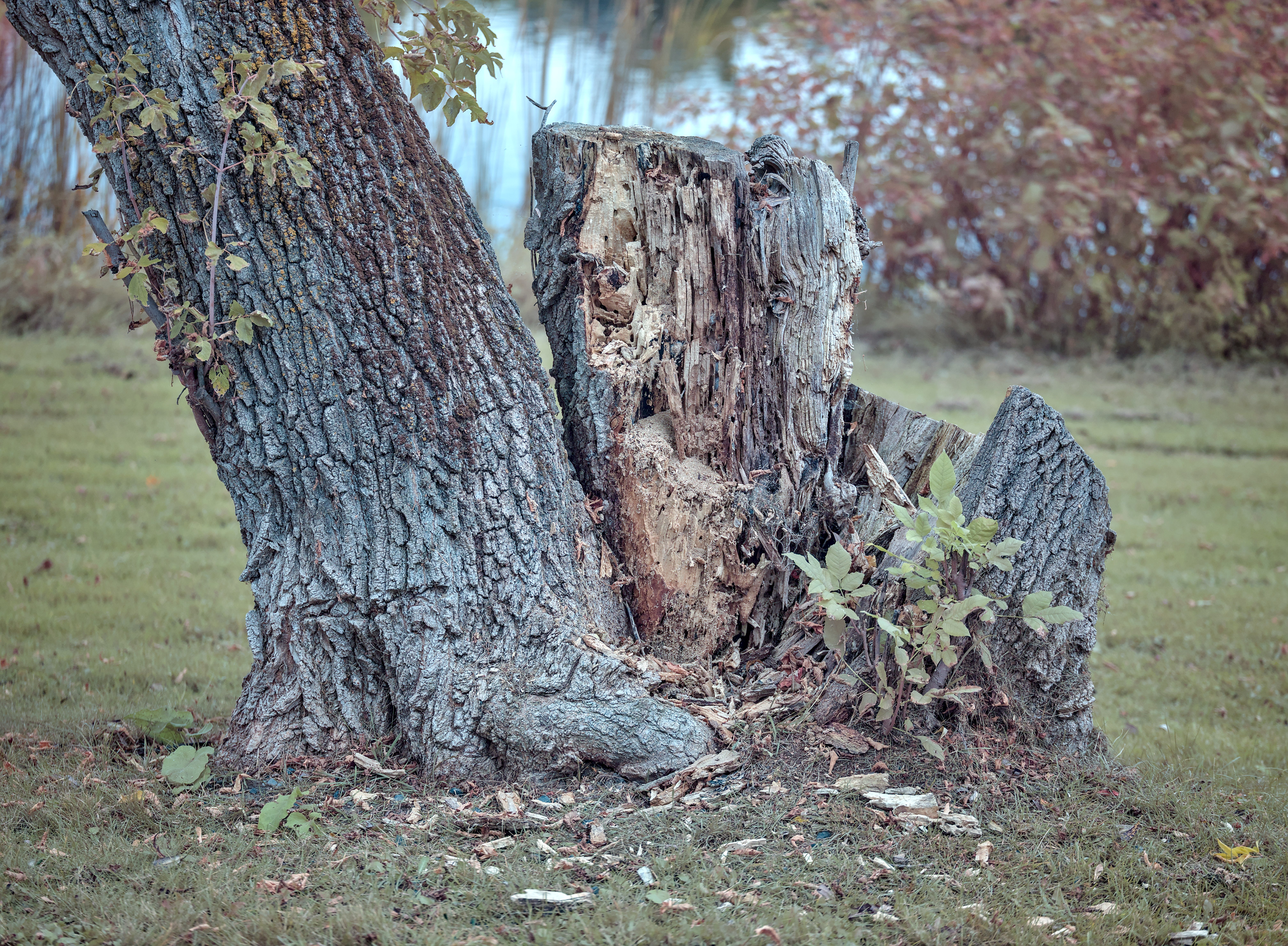

Same comparison with tree scenery much closer:
Regular camera (Fujifilm GFX 100 II Project Poseidon) with GF32-64/4 lens, 1/5” f/8 ISO 100
Then modified GFX 50S II body but without any filter on the lens, capturing both UV+visible+IR components. Because IR spectrum contributes much more than other colors we get this sepia look as result, 1/13” f/8 ISO 100:

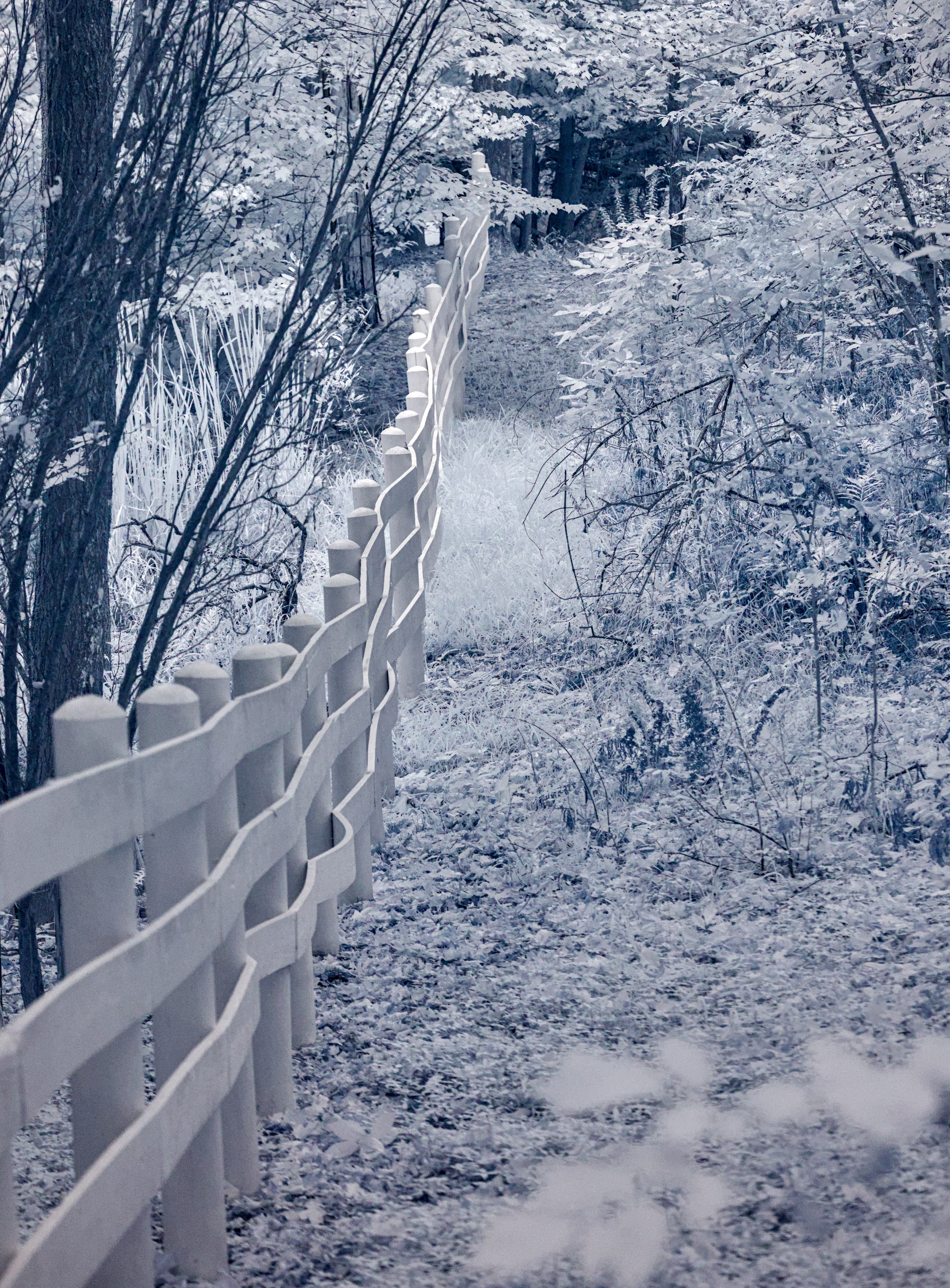

Capture with GFX 50S II in infrared with IR pass filter with GF32-64/4 lens, 1/8” f/8 ISO 100

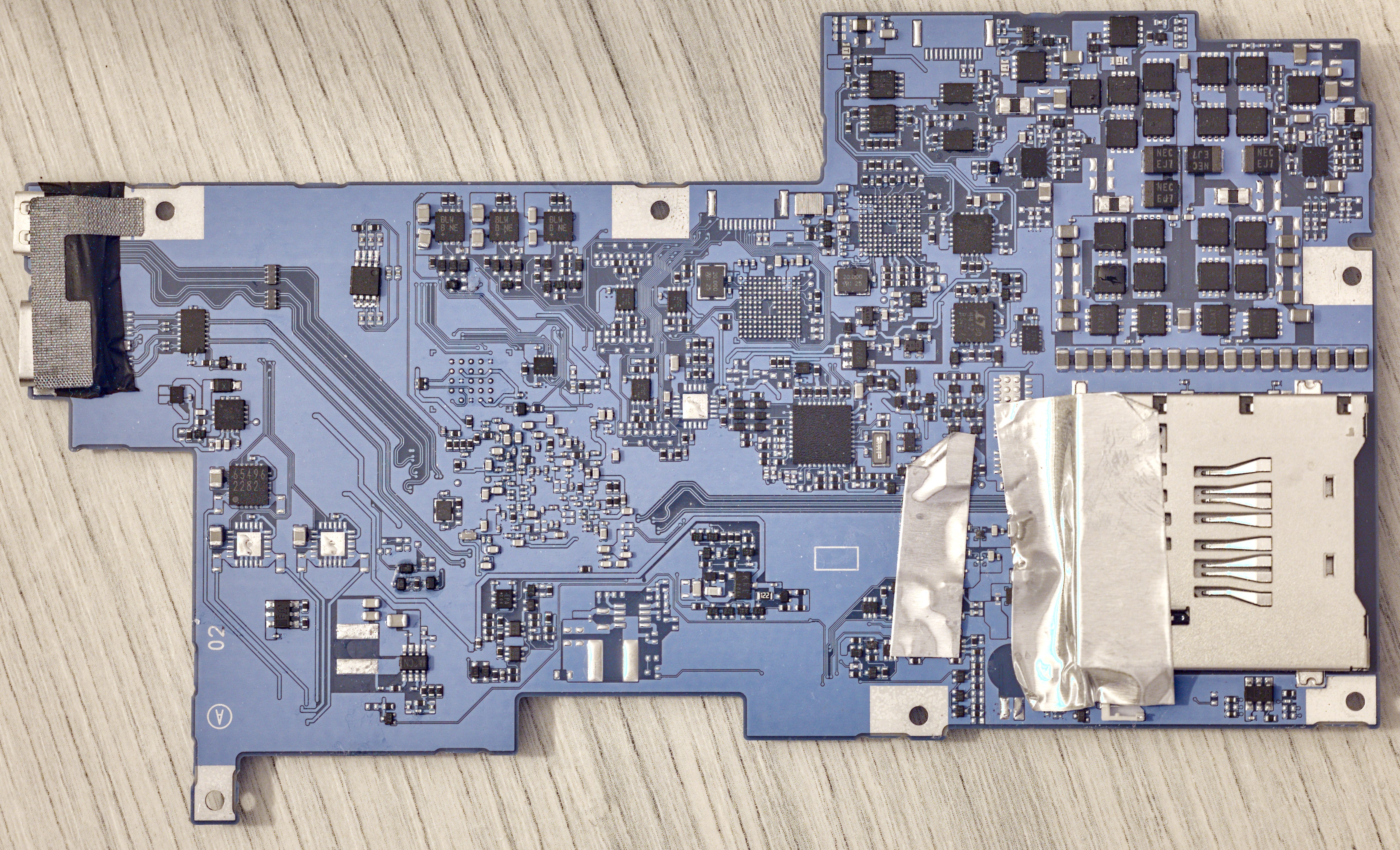

GFX 100 mainboard PCB in infrared does not reveal anything too interesting, compared to regular photo from my teardown here

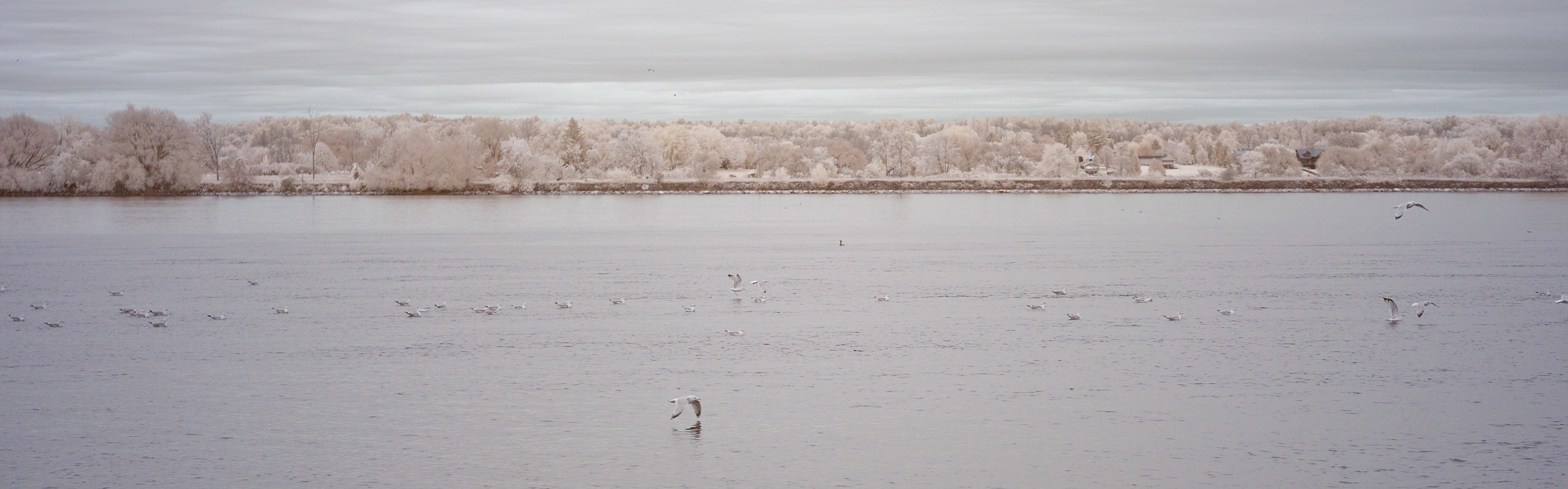

Infrared panoramic image:

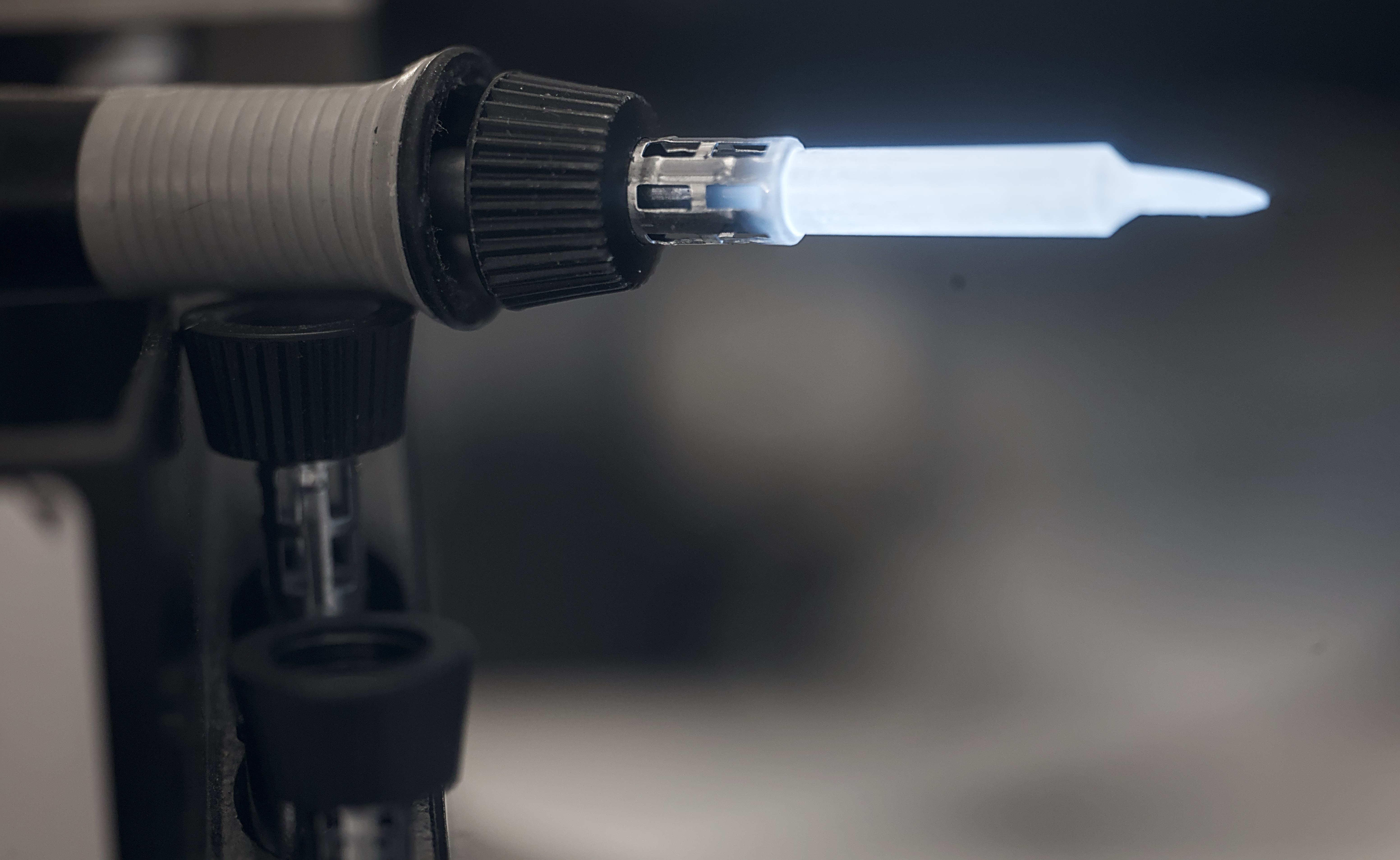

Converted camera is also useful for imaging high temperature objects. Here’s operating ERSA I-CON 1 soldering iron with tip temperature +450 °C:
Surface must be above +300 °C to radiate enough infrared heat in near-visible spectrum for such captures to be practical. Pretty cool still to see thermal radiation with such high resolution camera. Same scene recorded in video mode on modified camera:

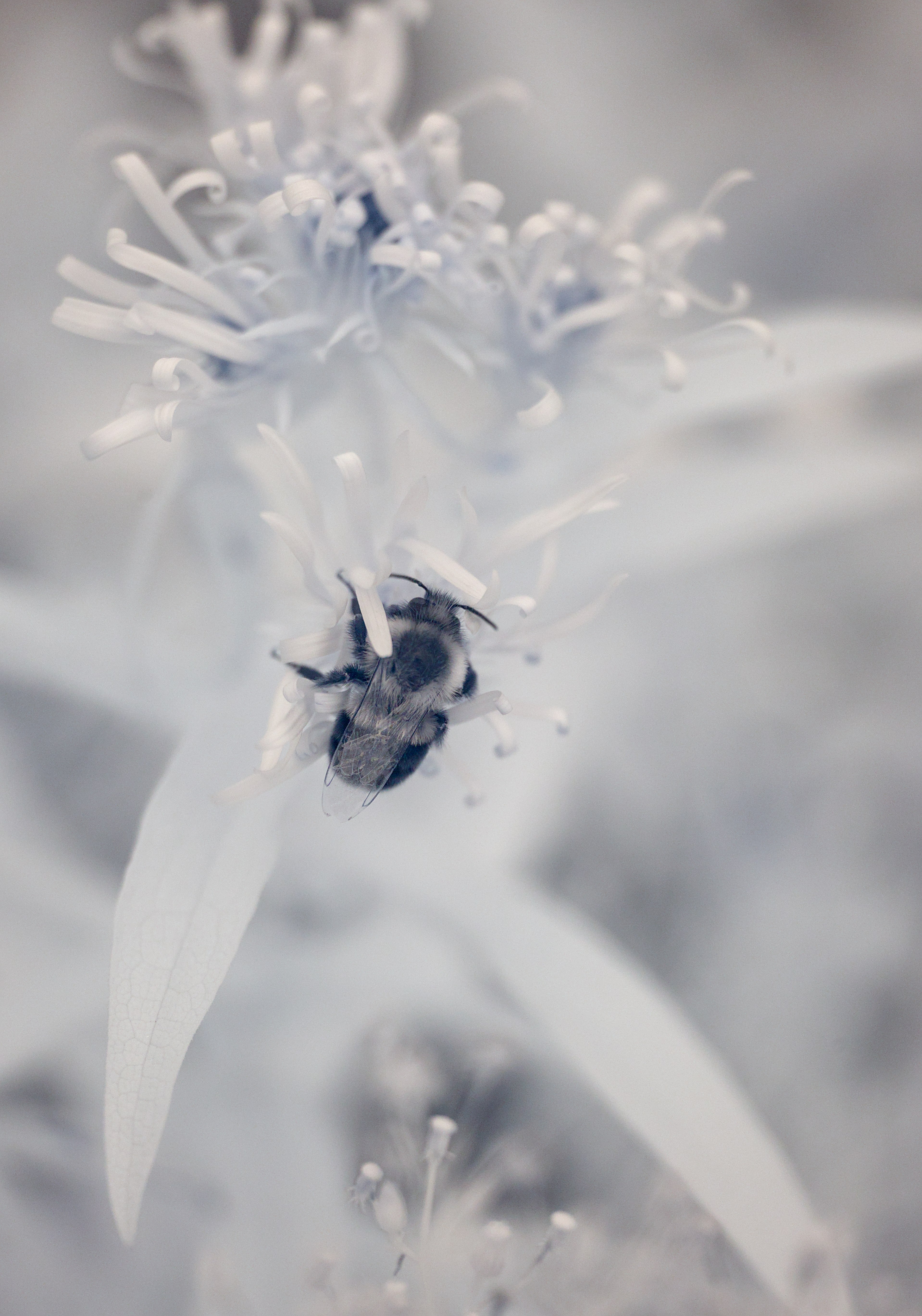

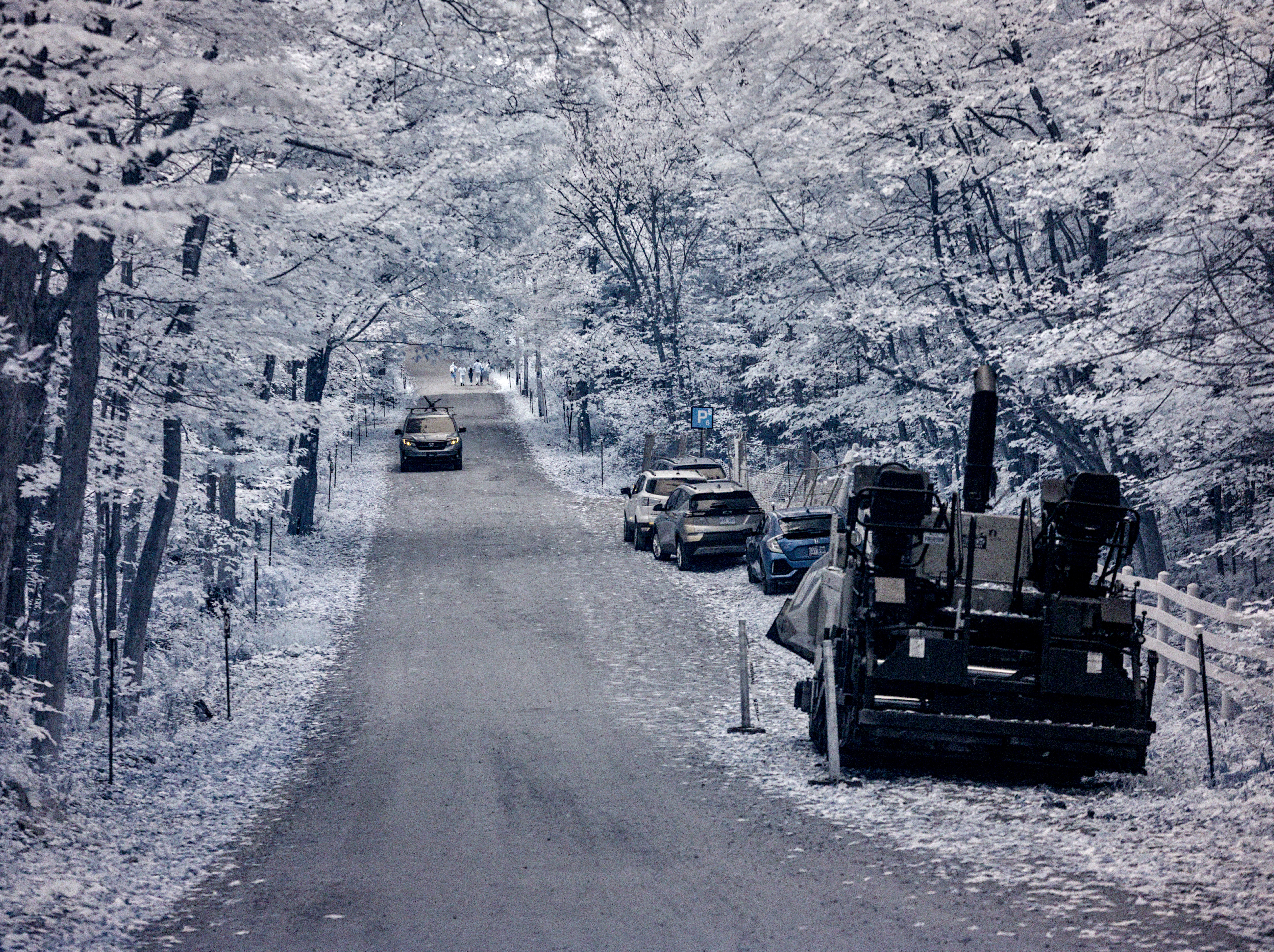

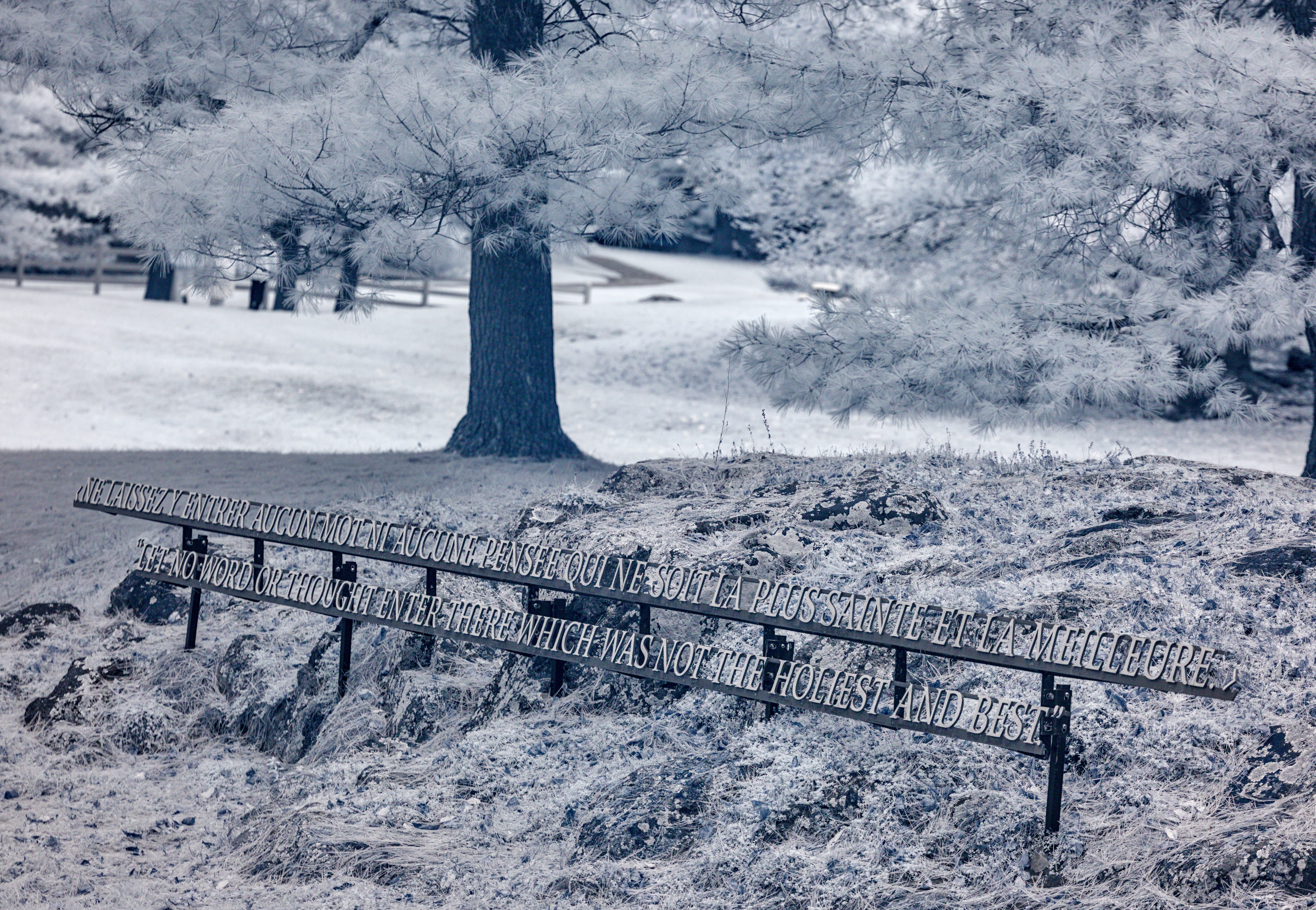

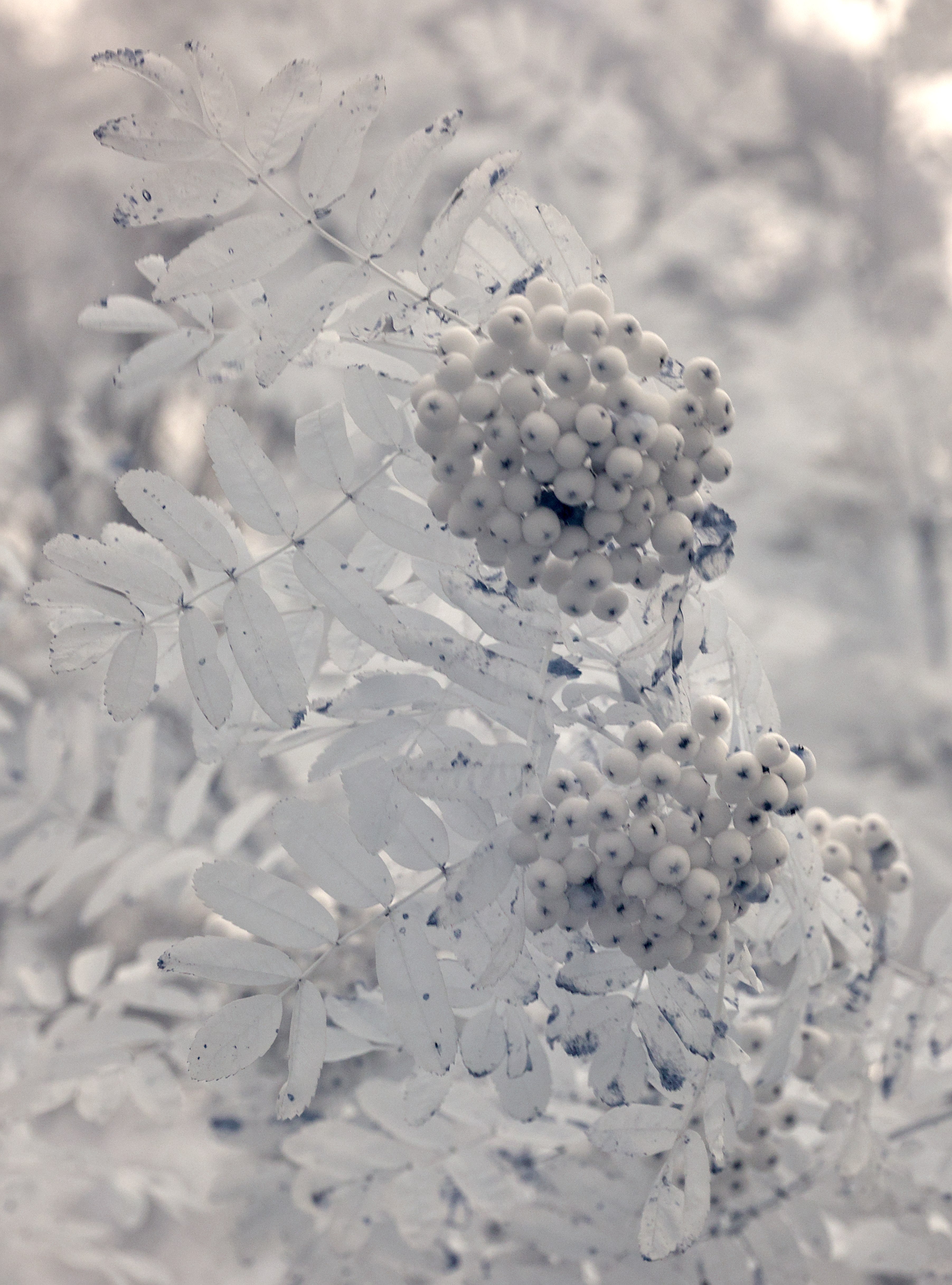

More captures with IR filter attached to lens
Just like with other set most of images here are with Fujifilm GF 120/4 Macro lens and IR pass filter on front.

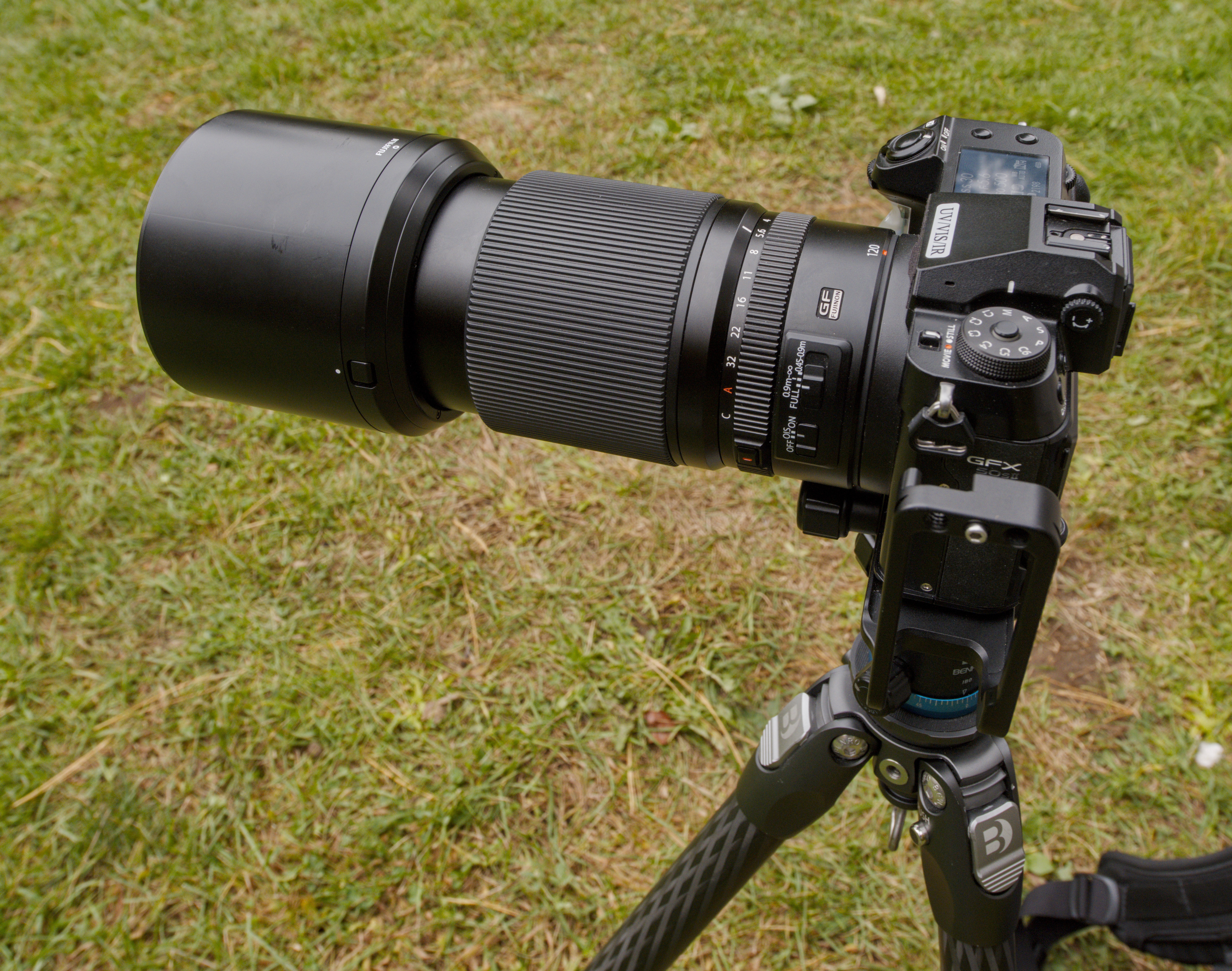

And finally, actual modified camera itself with GF 120/4 attached, looking just like any other camera from the outside.
I’ll test more lenses on modified GFX 50S II IR body later on to see how they work in this application. Author of all these photographs also here in infrared during the test shoot session :)
